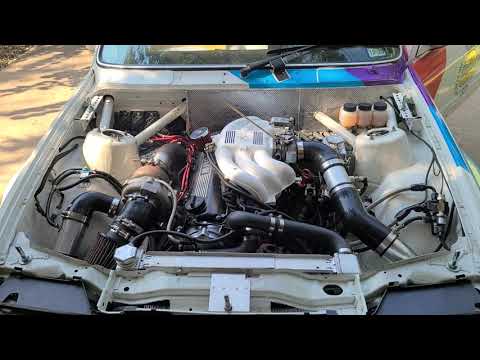

                      Das Beast 2.0
                      Getting there. Lots of work planned for this holiday long weekend.
                      We ditched the air box altogether. I really like the new look.
                      Cold side was easy to reinstall. We moved the IAT sensor to a welded bung near the BOV.
                      Close now. Rad goes back in tomorrow then down on the floor for a compression check. Rings aren't broken in but it won't make a huge difference at 100 RPM. It's just a sanity check.

                            It's Alive!
                            First start. Ran like a champ. Frigging static compression is 180 - 200. Yikes!
