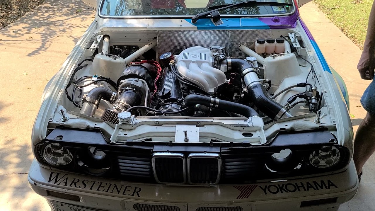

    Only thing today was figuring out the dreaded timing belt fuzz. Remember one of the issues was something eating our timing belt? Turns out it was screws for the distributor cap delete plate protruding into the belt way. Pulled the rad, top hoses and timing cover. Trimmed the screws. Problem fixed.
    It's idling great. oil is 25 psi hot. Fuel pressure 40 psi at idle. Nominal is 45 psi at 0 psi boost, but since idle is under vacuum it pulls down fuel pressure a bit. Perfect.
    Break in driving. Fuel pressure at 45 psi under throttle, 60 psi oil pressure. Water temp rock solid at 180. (After we burped the cooling system a few times) Oil pressure never goes below 25 psi under braking. No oil or water leaks.
    Next Steps are go get inspected, put break in miles on it, change out the oil then go for a dyno tune.
