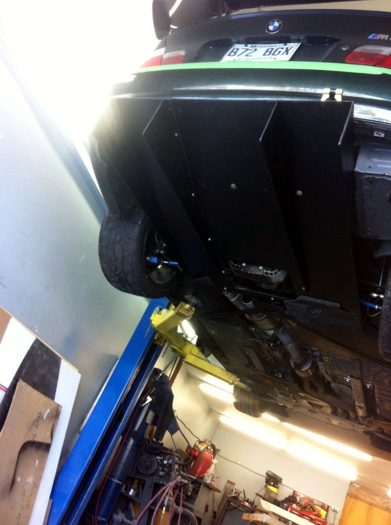

                • dvallis
                  • Oct 2015
                  • 1474
                  #83
                  Right. Something like that. Here's another real diffuser. Functional, vs. made for looks. The base pan is from a fiberglass mold, with sheet metal center channels. (from this thread)
                  And on the car. E90 I think.
                  "And then we broke the car. Again." Mark Donohue, "The Unfair Advantage"
                  1987 E30 3L Turbo Stroker Das Beast
                  2002 E39 M5
                  • 2mAn
                    Señior Mod
                    • 21038
                    #84
                    thats an E46 but who cares. Im excited for the next phase now that you've deleted a 1/4 ton!
