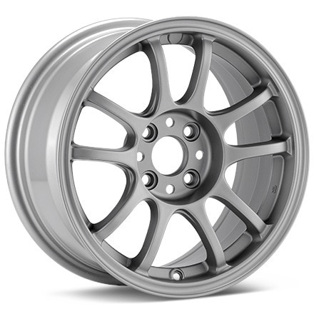

                  Went back to the tire shop for matching rear tires. I weighed the rims when they pulled them and dismounted the rubber. Would you believe the rims that came with my $1000 E30 weigh 14 lbs ?! WTF? No wonder there were wheel locks on them. I know it's a long shot but can anyone identify these rims. 15 x 7
                  That means I saved 44 lbs total compared to stock 25 lb rims. Rolling weight is now 2,389 lbs. Race seats, sunroof delete and heater core delete will easily get me down to 2,200s.

                      The wheels are TRM, a pretty popular wheel for the real racer crowd
                      How do you figure deleting the sunroof and heater core, and replacing the OEM seats with race seats will drop 180# ?? Sunroof is about 30# from what I remember. Keep it up though, and when you're done go get a real weight measurement. Im curious.

                        Found it. Tha "JW" thing above is an Enkei symbol. Wheels are really similar to PF01 but they look like an older discontinued model since weight is 14 lbs each.
                        I could shave off 3 lbs at each wheel, 12 total, with an RPF1 15x8. The current 205/55/15 tires weighed in at 20 lbs each and 225/45/15 are also ~20 lbs.

                          Simon, missed your post. I'll look into TRM wheels.

                              You called it. My wheels are definitely TRM C1. 13.6 lbs 15x7
