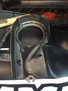

      Sorry to report back so late. I did the tests as suggested above but noise didn't change. I decided to swap the timing belt, tensioner and water pump. Something I noticed when I removed the timing belt cover was the contact and groove formed from the belt rubbing on the inside. Is this normal? What prevents the belt from moving in and out on the cam and crank ?Click image for larger version
      I think would be the most logical source of the noise. On slight acceleration, engine speed increasing.

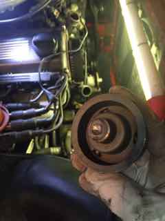

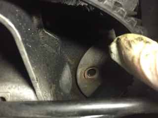

        Another update. Definitely was the tensioner! Holy crap I got lucky. Thank you R3V!!! Click image for larger version
ID:	7182272Click image for larger version
        It was wobbly and I grabbed it to spin and checked for noise. It fell off in my hand.

              • dinan3
                • 52
                When I had my head gasket done it was supposed to be replaced. It only 6k miles when mine fell apart. Looks like the bearings or race seized and sheared itself.
