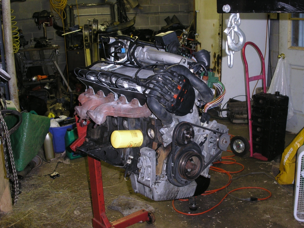

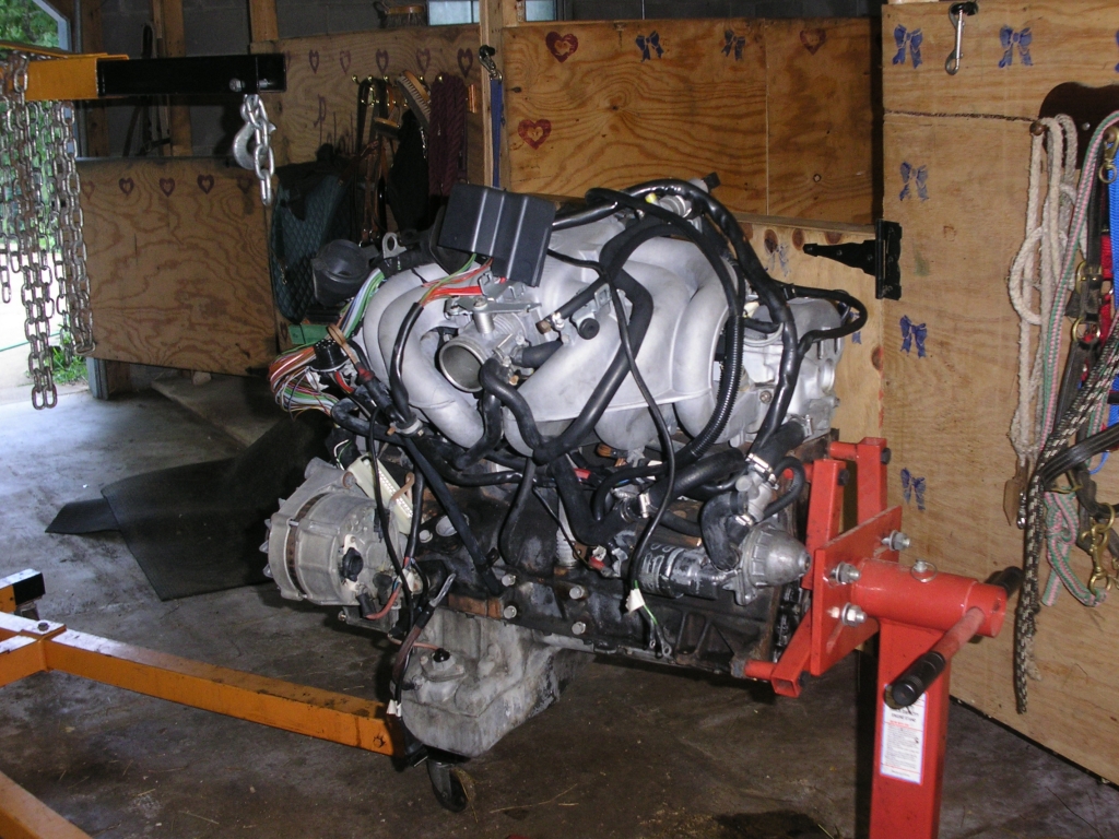

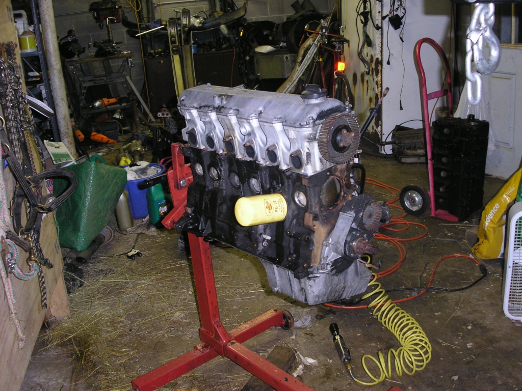

    Well the engine in my eta has been burning a lot of oil, and has just revently started to oil foul the plugs. Not having much money to work with, I decided to start building a low cost, average powered stroker.

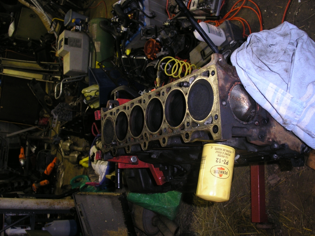

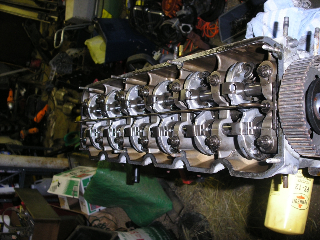

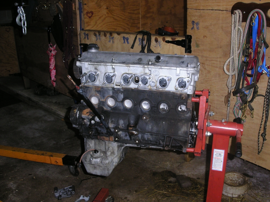

    I'm starting off with a 160k mile eta engine out of my 86 325es parts car
    I started tearing it down today
    The engine is getting all new gaskets, t-belt, water pump, headbolts etc...
    Then I'm modifing the head with an I cam, dual valve springs, Head ported out to I spec, full 325i motronic 1.3 fuel injection, MAF, etc...
    I'm hoping for 180ish at the crank. So far I've spent 900 towards the engine, everything is either ordered or purchased so some time this week the engine will start to come back together.

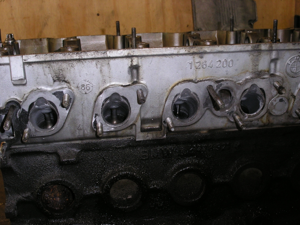

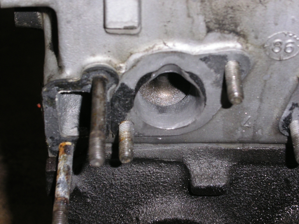

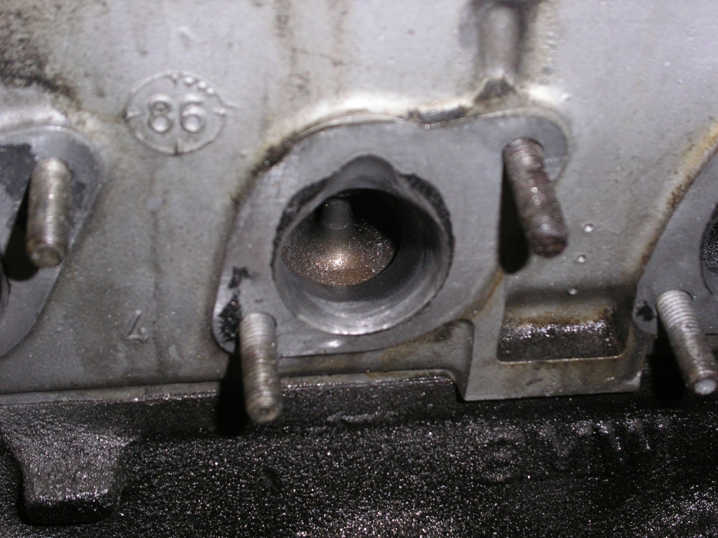

              ok I got the head off this morning, and just started the port work, I'm ussing an air diegrinder with a metal rasp to remove the major material then finishing it off with some 60 and 80 grit sanding drums.
              Intake port #1 after the ruff finishing
              For some reason this engine had 325i intake manifold gaskets on it, so they left that nice black ring which makes it easy to port. I'm staying clear of the top of the port as there is not much metal up there, so I've just been rounding the corners off.

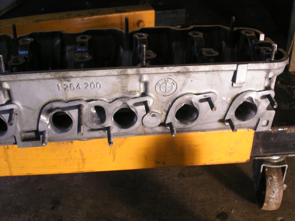

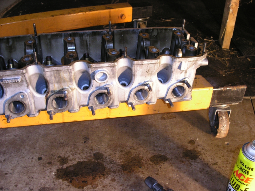

                  Ok I've got ports 1-3 ported and smoothed. Man it dosn't take long at all to port them out, Once I finish the intake side I'm going to just smooth out the exhuast ports.
                  Don't worry that's just a spair block I had laying around I set the head on so I could work on it easier.

                  • nando
                    • 34844
                    are you going to deshroud the valves at all? what about the ridges around the valve stems? I would have removed the valves before porting, the sears tool is cheap (~$20) and works well.

                    • rs4pro3
                      • 5808
                      I haven't decided yet If I'm going to smooth out the valve stems or not, I've got the sears tool, but left them in there as I want them to get cleaned when I take it to the machine shop. I'll probally go ahead and yank them so I can smooth out the ports better, And get the shop to clean them seperately.

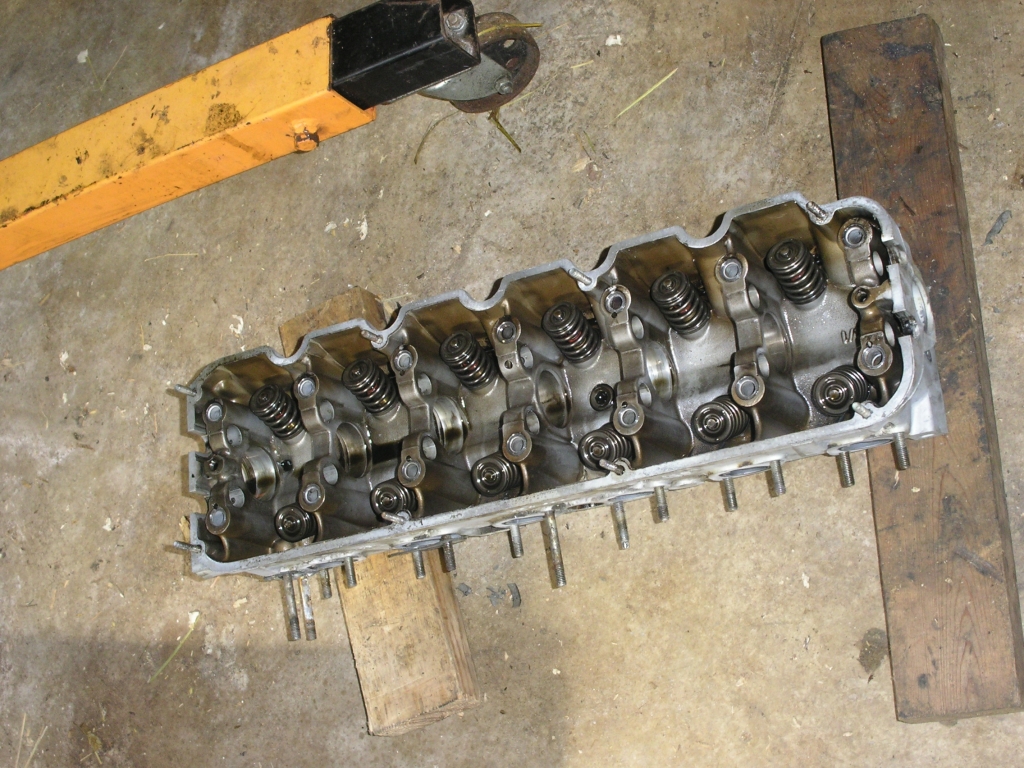

                      • rs4pro3
                        • 5808

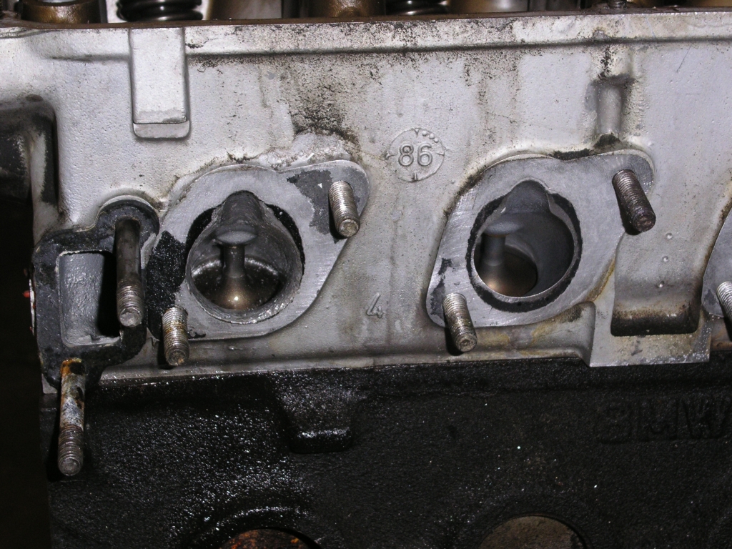

                        Well all 6 intake ports are ruffly done, I went ahead and yanked the valves, and I've seriosely thinking this head was rebuilt not long ago, the intake valves don't have a lick of carbon on them ANYWHERE, they look brand spanking new, so do all the valve guides. And actualy the guides that are in there sit basically flush with the ports as is.

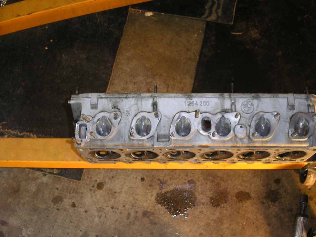

                          Head is all ported and ready to be machined:D
                          Polished exhuast side
                          Ported and Polished intake side
