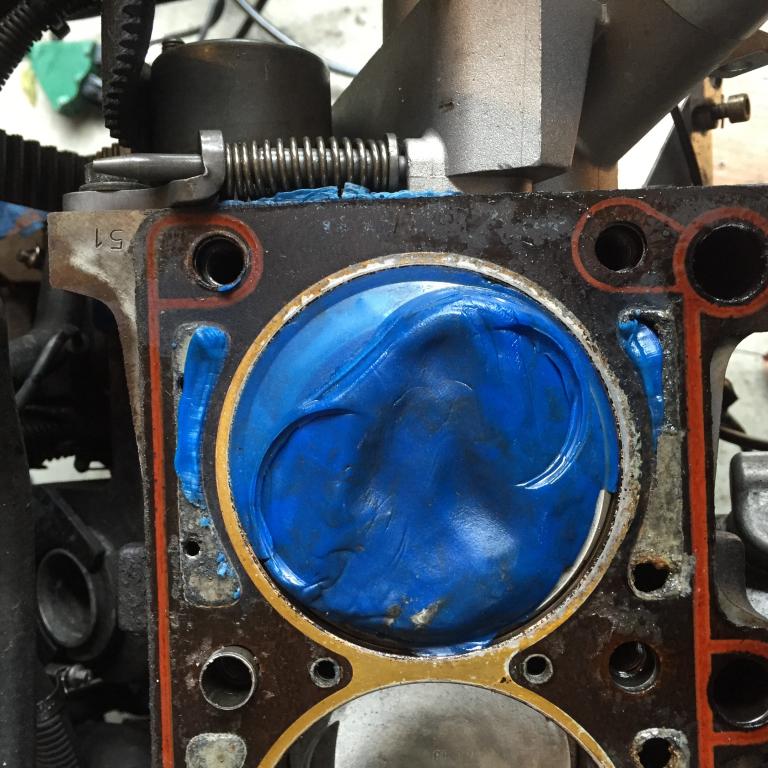

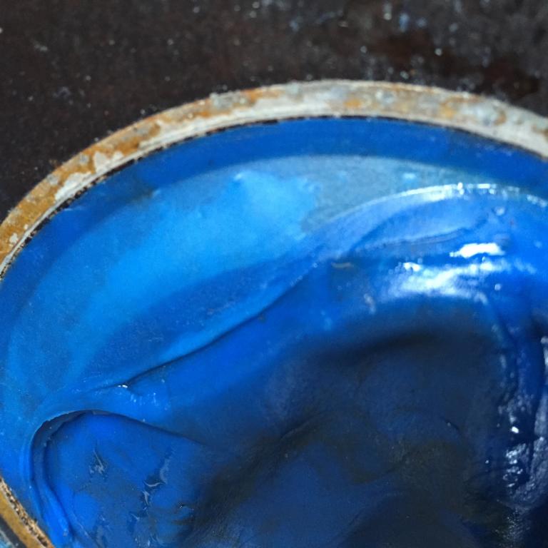

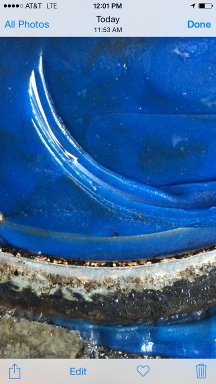

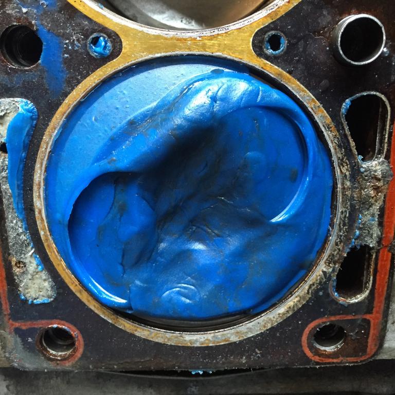

                  Ok. So it took me 4 tries to get a decent clay that would not pull apart... The photos speak volumes. When lifting off the piston these would tear, so measuring the areas that are piston to head clearance, right where it tore, I can measure up with .025 clearance.
                  So. Can I make this work with 2.05 head gasket. Should I get the Drexel out and tweak the high areas?

                    Additional photos

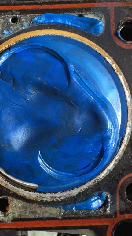

                      Additional photo
                      • korn
                        • Feb 2015
                        • 128
                        More

                            So. On that last pic, the clearance on the exhaust side of the piston was really difficult to measure. The top side was .030 +/- .005.
                            If I dremel the lower piston ridge down a bit on all cylinders, just "round it off, and slightly deepen the pockets of the valves. I should be able to bump the clearance up to .040. Added to the larger gasket...
                            Anyways; that's my plan- thoughts?
