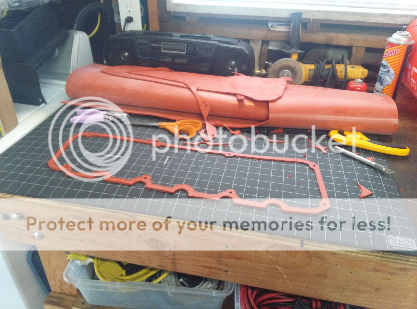

            I've chased VC leaks for what seemed like forever on 2 different e30s. Like you i exhausted all options. I even had a VC itself surfaced but that just makes it more thin and more susceptible to warpage. I eventually came to the conclusion that a more forgiving gasket is needed. Something thicker and rubbery like the 24v engines have. I contacted felpro to see if they would ever make a permadryplus for m20's but the answer was no. I took matters into my own hands and made my own VCG out of high temp silicon sheet. Bone dry now. Before the silicon gasket i would try something new and wait and see. I'd always check the exposed upper surface of the block as viewed from the exhaust side and after a few days it would always collect oil residue. Guess what, now that it doesn't have that oil residue anymore it has slight bit of surface rust :)

                I'll track down my order in the am and let you know. Here's a pic i dug up.

                  It's been so long since I've seen that rubber gasket material that i forgot I used to have a supply of it. It's one of those things you have for years until you lose it, but great stuff.
                  Neoprene if memory serves me and if you go slow with a very sharp blade I believe it's fairly easy to cut a clean cut..
                  Did you trace the outside then freehand the inside ?

                    I tracked down my order and material thickness was 1/8". The ebay seller was adrian22305. I'd provide a direct link to the auction but it's no longer available. Here's his store link though.
                    Yes exactly. I traced out an old VCG then processed out the silicon with an xacto knife, hole punch, and cutting wheel. When cutting out the silicon use the hole punch to put holes at as many of the transitions as you can. Then use the xacto knife to cut from hole to hole. Easier than trying to cut all those transitions with an xacto knife. Be sure to make it a bit wider than the old gasket and that it is clean and free of oil residue when installing to get a good clamp up on the gasket with out it squeezing it out since it doesn't have a rigid sheet of metal through it like a standard VCG.
                    Digger, i'll concede silicon may not be the best material but i've had my VC off a few times, reused the now flexible gasket mind you :), and it seems to be holding up well enough. I can't see any signs of degradation.
                    Was thinking how nice it would be if someone were to make a VCG of a rubbery material and have the rocker plugs and gasket molded as one. Fuck that would be nice.
