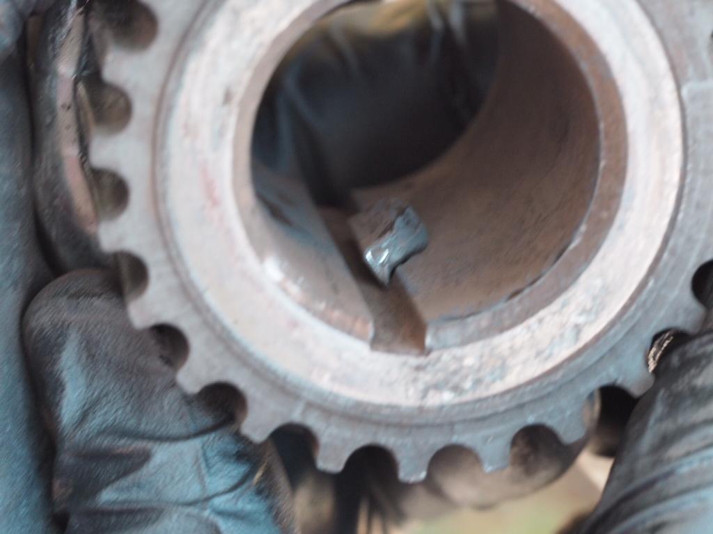

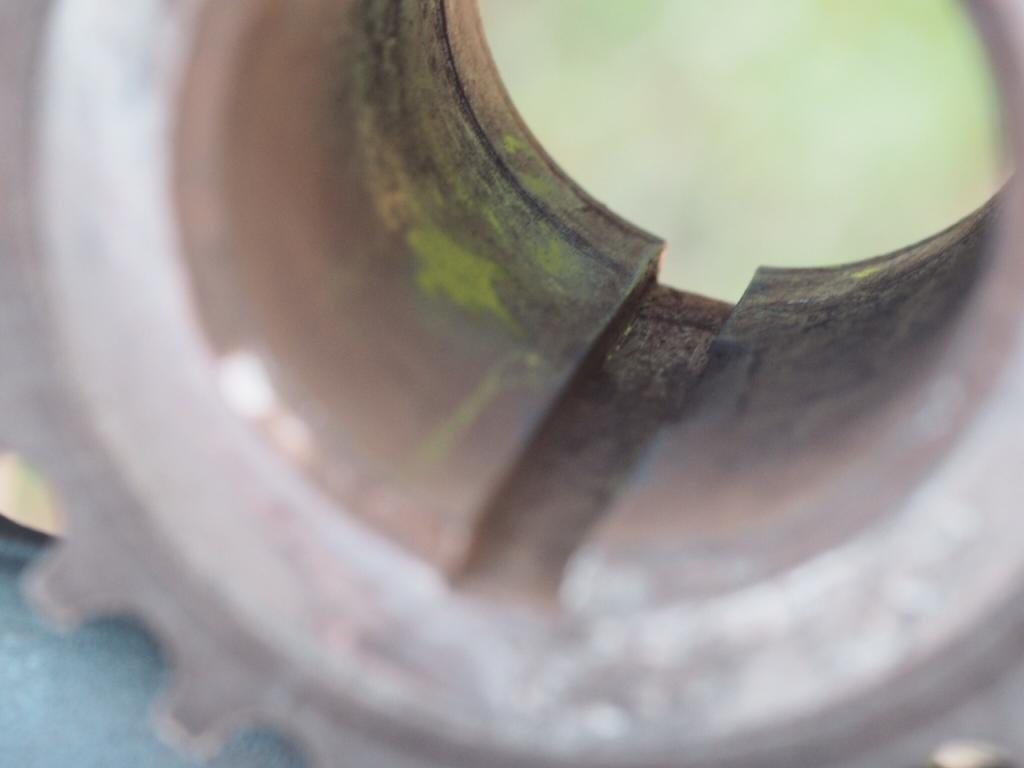

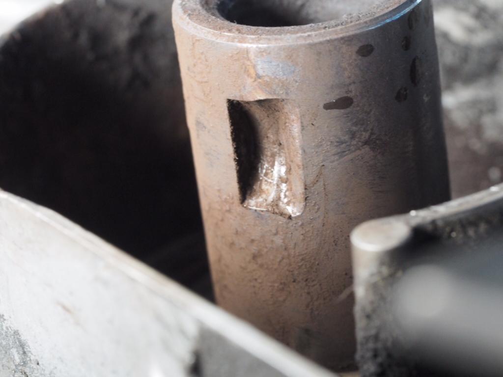

                          #42
                          Failed woodruff key
                          I pulled the timing belt, and this time also removed the crank bolt. If you've read this far you may remember that the bolt had been only finger tight when I first inspected the crank position sensor and harmonic dampener/toothed wheel.
                          Seems as though the loose fit may have allowed too much play, allowing the gear to spin on the crank nose, bending/smashing the woodruff key, and damaging both keyways in the crank, and in the gear (see below).
                          For grins, I'm going to get a new key, and new gear. I'm hoping the keyway on the crank is still reasonable enough that with the bolt tightened to spec, and the tolerances tight on the key and gear, it will hold together and keep the timing correct. If not, I'll swap the block out for a good used unit, and keep my head and accessories...
                          Not the outcome I was hoping for - but I'm glad I found what appears to be the root cause.

                              I started researching Belzona and Loctite 660 keyway repairs - some people even do it with JB Weld. Looks like it might be a real solution... at least a first step before I replace the block/crank.
                              Anyhow - I'll continue posting with my results - but it'll be a few days before the woodruff key and new gear arrive.

                                #45
                                Solved it!! Sweet sky above!!
                                The failed woodruff key was the culprit.
                                I bought a new key (less than a dollar!) and a used crank gear (40 bucks) with a good key slot.
                                I used loctite 660, with the corresponding accelerator to fill the wallowed area in the crank, and to hold the new key in place while I installed the new gear. The gear is stubborn, and takes some force to press onto the shaft, but once tapped on far enough,its easy to press on the rest of the way with the big ol' crank bolt. Basically followed the process detailed on miata.net - the first year miatas seem to eat their crank woodruff keys, and this is a proven repair for those. http://www.miata.net/garage/hsue/crank/loctite_3.htm
                                I also used loctite 680 on the crank bolt/washer/gear mating surfaces, to help keep the bolt from spinning loose ever again. Torqued to spec (304 ft/lbs).
                                Replaced the water pump, Timing belt, and pulley for good measure, made sure everything was lined up - crossed my fingers and....
                                She started right up!! Idled WAY high though - about 1800 rpm. I figured the DME had adapeted to advance the spark timing as much as possible to try to compensate for the retarded crank gear/toothed wheel before, so I just let it sit idling for about 5 minutes (used the time to bleed the coolant).
                                It figured itself out completely, stepping down from 1,800 to about 1500, to 1,000 to 650 over the 5 minutes.
                                Took her for a spin, and the power is all there!! No more hesitation, no more flat spots, no more anything. Just a smooth running m20!
                                I'm stoked as hell!
                                Bottom line - if your timing seems off, but your timing marks line up - check the woodruff key.
                                Hope this ordeal helps someone else in the future! I'm gonna go drive!
