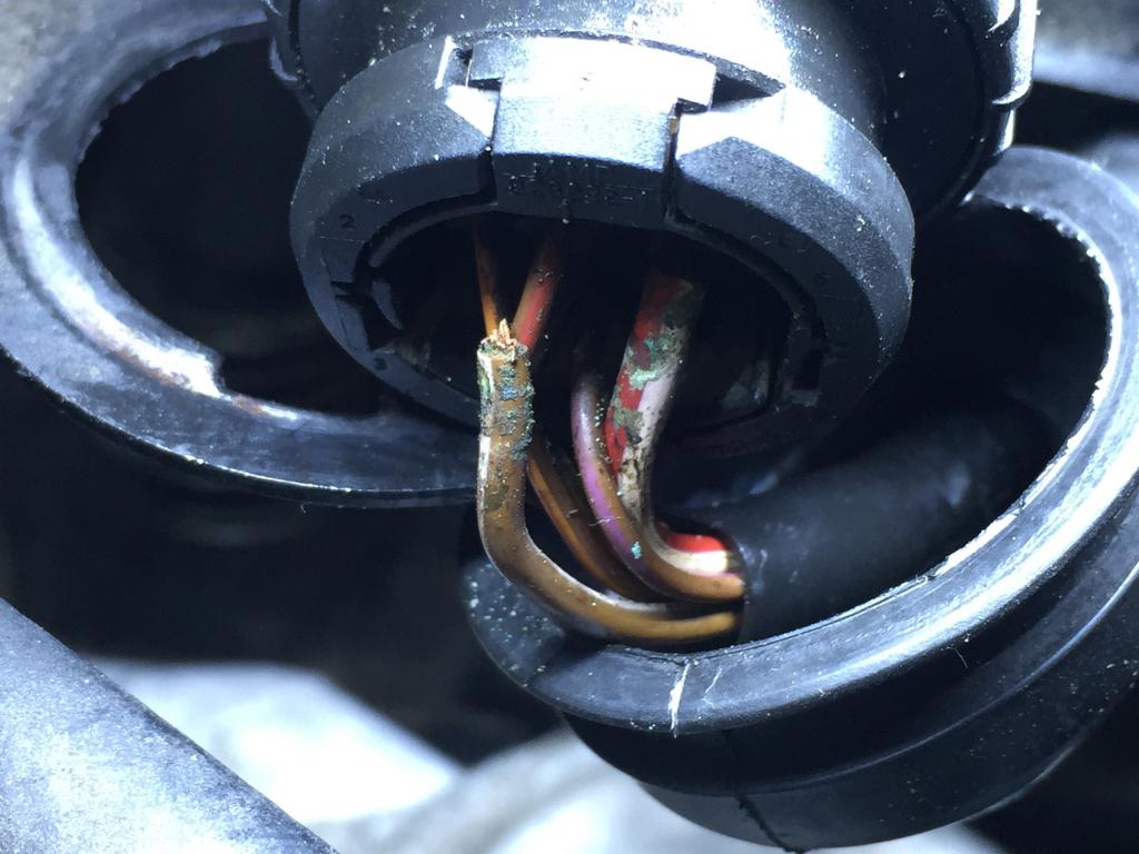

            Went to the junkyard got a spare CPS. Factory BMW unit. Still does it. Also tried a replacement coil, bosch unit. Still happening...
            This is the ONLY lead I can seem to figure out. 2 wires on the distributor were loose and the one with that weird sensor on it was all corroded. Would this cause that issue?
            The rest of them were all nice and shiny..

              That looks so bad. Time to replace the distributor cap and rotor.

                    cap and rotor replaced, wire was cleaned up and made no difference.

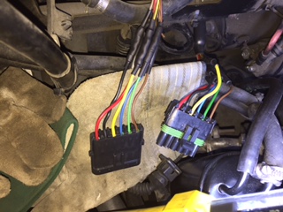

                            I hope you found the problem. If not, do more than just check the connector for corrosion. The wires could be barely hanging on to the pins due to corrosion. I had intermittent stalls and bucking which worsened when I replaced the TPS, AFM and fuel purge valve which I thought were the problem, but only increased afterwards. I disturbed the C191 connector during the work and inspected the connector thinking the problem were corroded connections. Well during the inspection 3 wires were either corroded from the terminal or barely hanging on.
                            Replaced the BMW coupling and pins with Weatherpack; so far, no more surprise stalls on the highway which is pretty stressful when you are in the fast lane during the stall.

                              Wanted to follow up for anyone else experiencing a similar issue. I replaced the ICV. This caused the car to buck on the highway till the CEL came on and it went to limp mode. Idle would hunt a bit as well. I tore out the c191 plug and replaced with a Deutsche connector. This did not fix the issue either. Finally, i went back and swappd my ECUs as i had a second ECU i had ORIGINALLY swapped before acquiring an ICV. All symptoms went away and the car drove beautifully.
                              Concensus: the high resistance on the failed ICV blew out the idle circuit on the ecu. This meant it was not correctly metering air causing a lean condition on the highway due to being open too far. When the car went to limp mode it was adding enough fuel for it to drive problem free.
