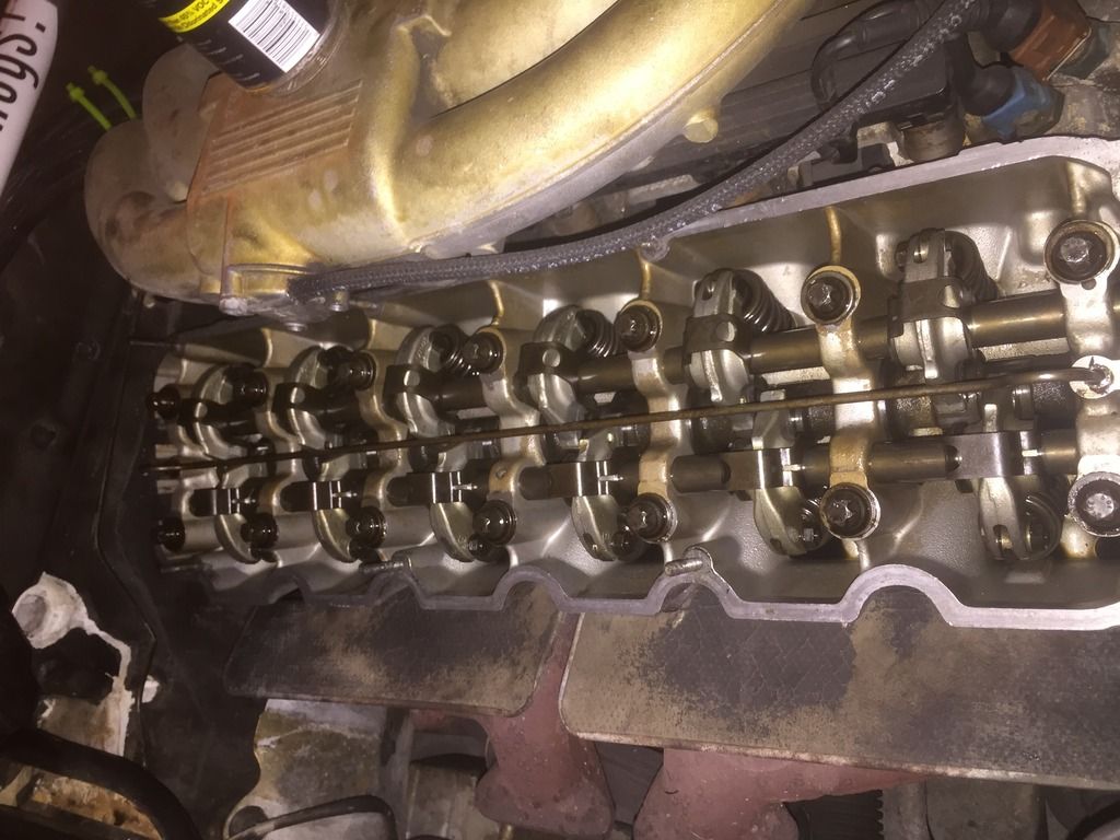

                    Hey guys I got all the new parts on tonight. New Bosch plugs, victor VC gasket, half moon plugs, and VC vent hose. She turned over immediately! A bit of white smoke coming out of the tail pipe for the first 5 mins of it running though. I took it out for a quick jaunt and did some pulls through 1 and 2 up to redline. Felt noticeably better. Also I'm happy b/c it looks like my head is pretty clean:
                    Thanks again for all the help and advice. I'm planning on another compression test in a month or so. I'll prob do an oil change by that time too and go with the diesel oil.
