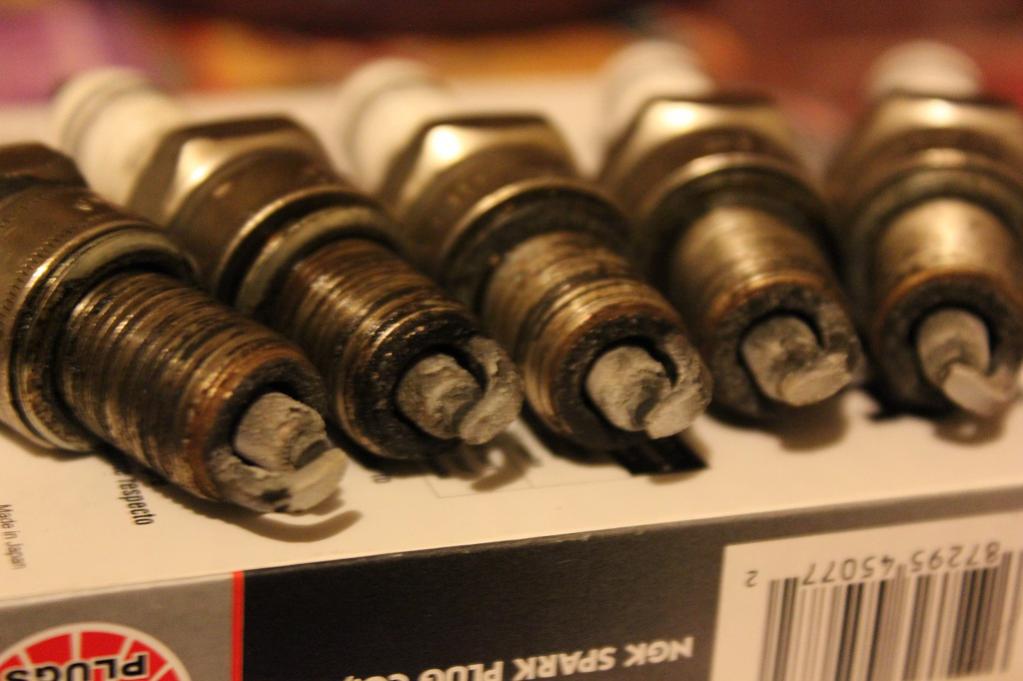

        Update: It was the plugs Wish I started there like a normal person.

          It's running fine now? Great to hear it was only plugs!

            It's running great now. I believe it was caused by those insulators. They looked awful. Thank you for the suggestions though! The help was appreciated. I'm also going to PM you about some tuning options.

                    I bought another AFM to test and play with. Adjusted the sweeper arm, cleaned the contacts. Pulled the flat spots out and was happy with the results. When completed I noticed I had broke one of the small wires that runs to one of the pins. It was a small non-insulated silver wire. Pin 3 or 2, can't recall. Someone wanna tell me what that tiny little hair of a wire is for?

                      Cleaned my injectors. It looked like I pulled 6 black turds out of my fuel rail. Used a whole can of carb cleaner! Will be throwing in new plugs tonight.
                      The old injectors were so bad I could not see the spindle caps or points.

                            Squid- I thought it did, it was like the previous time when changing the plugs. Runs like a fine tuned Singer for a couple of weeks and then the plugs go lean and I have a miss below 2k. It did seem to help, I guess I will be buying a Walboro and a new FPR.

                                Originally posted by HerbE30
