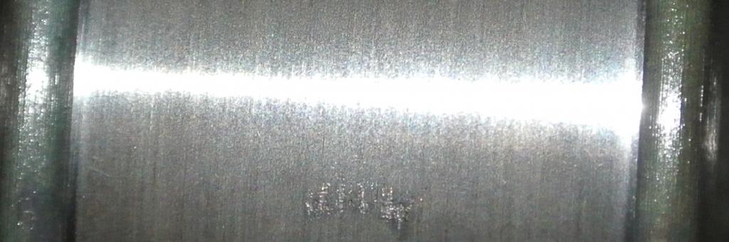

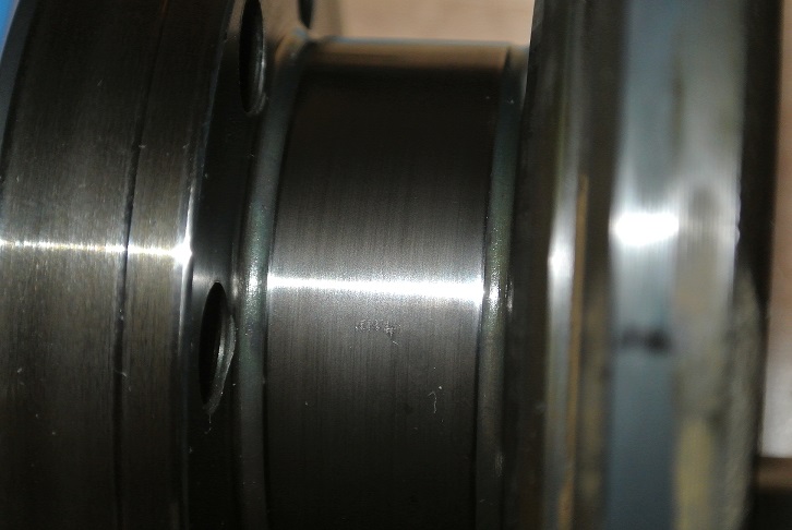

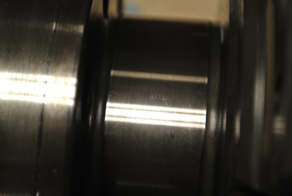

    Well...I picked up my block and crank from the shop. Not too happy..
    I had this crank examined up and down under the magnifying glass, it was perfect. Long story short, I took in for some cleaning to the machine shop while they were doing my block. This is what I found when I brought it home (pic).
    Brought it back and the shop said it would be ok to use it. He told me he can clean this journal once more, threw it on the lathe and used 400 crank belt. Obviously scoring is still there since the only way to get it out is to grind. This crank will go with late style bearings (lower one doesn't have the oiling groove) otherwise it would be dead in the middle of the groove.
    I'm really OCD about stuff like that. Would you guys use this crank? I have another M52 crank but I already pressed the oil seal spacer on this one and would hate to buy another one.

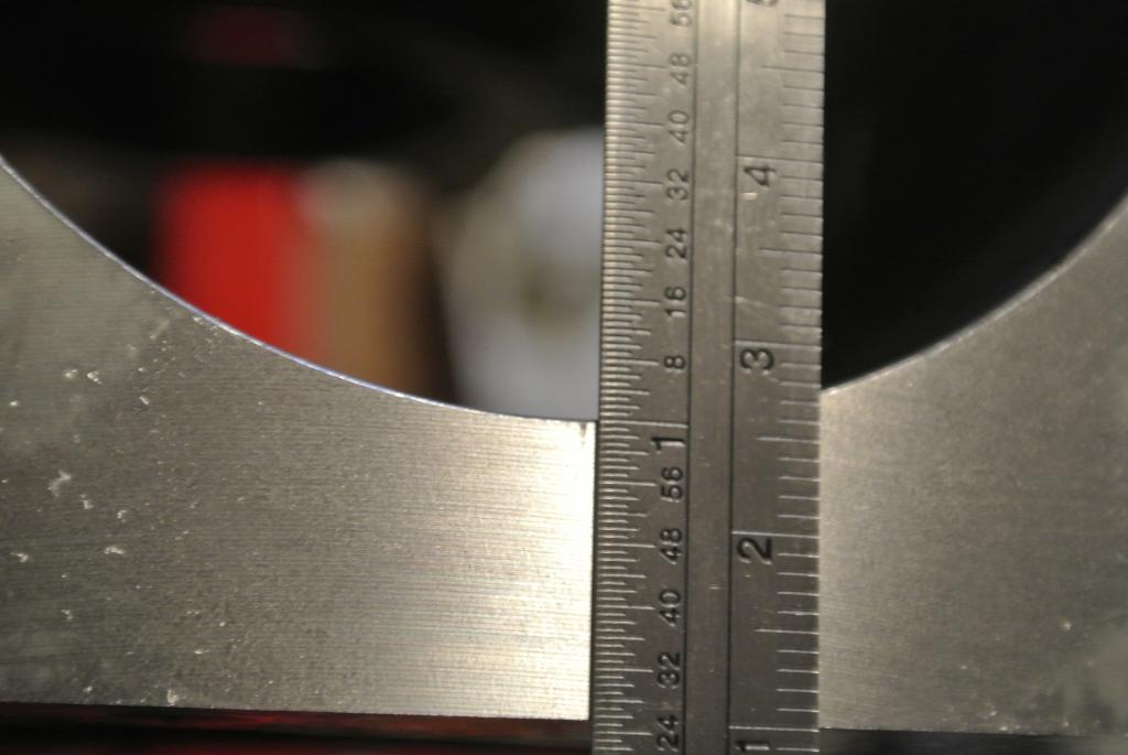

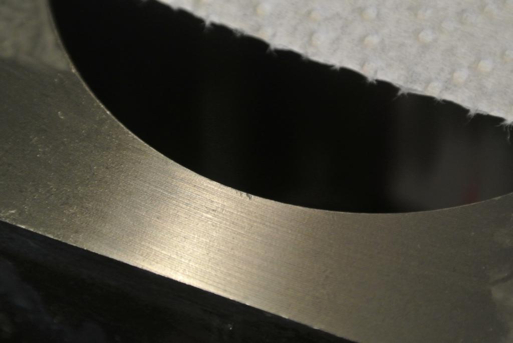

    Another think my OCD is not 100% happy about. Deck looks beautiful with the exception of these two spots, both are dead center for bores at cyl1 and cyl6 only. Block had bore/hone and deck done to it. Hopefully I can use OEM gasket and don't have to go to MLS to get proper piston to head clearance.

      i think the deck is fine as long as there isnt a tiny burr that sticks up in which case you can rub it down carefully, though its not ideal being directly under the fire ring and i assume you are at 85mm bore? sitting the gasket on might see how much is in free air?
      the crank id get a second opinion from a shop that doesnt have a vested interest (photos can make things look worse than reality) , since it doesnt polish out it might be a little too deep. are you saying that it wasnt there before?

        can you feel if with your fingernail?

          correct, crank was selected out of a few and it was perfect. I can't prove that they did it since I took it home (it was wrapped) and I don't really want to start any wars with the shop. It is definitely deep enough to require grinding (finger nail, copper penny etc) but it's flat with the journal. I definitely do not want to grind the crank. Wonder what harm can it do since it's flat with the journal.

            If your shop is reputable and you are spending money with them, they should be able to lap that crank back. We recently had one with deeper grooves and polish took it out (it's a main, so you have a little more leeway for sizing), and they didn't even question if it happened during transport back to our shop. Worth asking if they will re-polish it, just take note of the diameter. We make it policy to NOT turn the BMW cranks to .010", we just replace them.
            As far as the deck, it appears they scraped it with the hone upon exit, but unsure why the deck would be milled before the hone jobber. How much did you take off the deck? You start new threads often, so not as simple as a scroll up to see your particular build - but - in my experience a .010" scrape off the deck leaves room to do another rebuild and keep a decent quench with a -.005" head. Really until you have both components machined, you have no idea how much room you have left.

              that's too deep for polishing the crank, according to them anyway. Needs regrind. This journal marked green from the factory and after polishing, it still sits at 2.3613.
              Deck needed about 5 thou removed to get it flat. Was too pissed about the crank, didn't want to get into the deck with them....probable should have.
              I'm doing 2.9L: 85 bore, 84 stroke
              Can someone explain me what would be the issue with running something like that? It's flat with the journal surface.

                  You have a tenths mic to measure to the 5th decimal?
                  Let's convert mm to " for the sake of this thread. 59.971mm is the minimum stock journal size = 2.3610", so you have 3/10th before you even meet that (white bearings). A 2.36" journal means you need about .0023" of oil clearance following the 10's rule (.001" for every 1" of journal on the mains).
                  So, take a polish (probably closer to .0005" than .005"), and you are still very close to acceptable in a race-oriented engine. You are splitting hairs when talking about one or two ten thousandths of an inch (now you are talkin RA finishes).
                  In short, I agree with Digger, get a second opinion. A mic itself can "scratch" tenths on a polished journal. I bet a polish will take that right out. The machine shop shouldn't have an issue with re-polishing it, even if they did and blame you, most shops only charge ~$50-70 for a micro polish, so offer to split it with them if they balk.

                    Gents, thanks for the advise. FF, I asked the shop to mic all journals for me. That shop is very reputable too. I brought it back and was told that polishing won't take this off. I will find another shop to discuss this. Are these journals coated or just heat treated? If coated, how much can be taken of without the need to recoat?

                        Another shop said that this journal would be just fine as long as nothing is sticking up. He said one can drill a hole in the journal and it would be fine as long as its edges aren't raised (obviously it won't be good idea due to some decrease in the bearing area). Kind of makes a sense.
