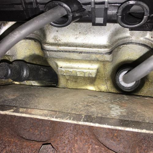

    I bought a 1990 325i Sedan about 18 months ago. Based on VIN and realoem this car is supposed to have the m20 2.5l engine. I'm trying to confirm this is the motor I actually have in my car. The reason I'm wondering is that the head only has 2.7eta on the casting.

      I know I have the 2.7eta head because of the casting on the actual head and that is why I'm concerned they actually swapped to the 2.7l engine. I'm thinking someone may have wanted to build a 2,7l stroker so did the swap but just hadn't put on the 885 head yet due to all the other components that need to change to complete the build.

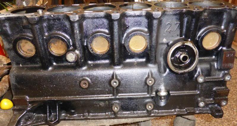

        2.7 block exhaust side..

          Ok, so thanks to LateFan for the awesome engine references!
          I've concluded I have a m20b25 block with a 2.7eta head. Go figure!

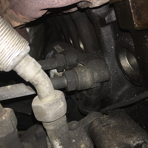

          Here's my logic (see photos). The block has lines going to the oil cooler which from my understanding was ONLY available on the m20b25. The head is clearly an 2.7eta head.
          The first question I have is if it is possible to fit the oil cooler to the m20b27 engine?
          The next question I have is how much performance gain would I get from changing the head to the 885?
          Thanks to all for a great forum!

              Did you see the photos of the head that shows it is the 2.7eta in the casting?
              Any thoughts on the oil cooler feature of the engine as shown in the photo and using that to identify as m20b25 instead of m20b27?

                if it is a real eta head then id suspect an eta block or atleast eta pistons . might be able to check in spark plug holes with one of those little cameras/borecopes to see the piston and combustion chamber
                you can retrofit the m20b25 oil cooler filter housing onto the eta block so this isnt enough evidence.

                  BTW, I used a mirror and was able to confirm the casting on the other side of the head was 1264200 so a "200" head.
