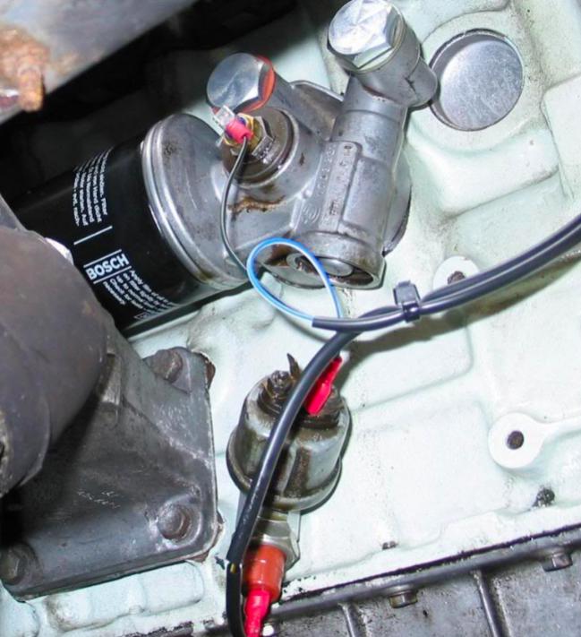

              So I went ahead and ordered a podi gauge with afr, oil temp, and pressure and got a adaptor for the stock oil pressure sender from bimmerheads..
              I kinda want to delete the oil cooler but idk what to tap into for oil temp if I do that
                  part # 11112140435
                  PS. I misread your post...thought you are looking for the way to delete the cooler....

                    a few options,
                    -a sandwich plate spacer
                    -same place as the pressure sensor
                    -11421265669 which is the same as the angled oil cooler head but without out the fittings for the cooler came on early m20 e21 perhaps e28 (pretty rare)
                    -sump
                    • Chrisbike
                      • Mar 2015
                      • 688
                      Originally posted by digger
                      a few options,
                      -sump
                      -I'm unsure if the sandwich plate will fit with my headers yet
                      -Same place as the pressure sensor won't work because there's nowhere to tap once the adapter is installed.
                      -Doubt I'll find one and I'm not spending $320 on one
                      -I'm susprised you recommend the sump as it reads lower than actual temp
                      I curious because I saw someone use bolts to block off the two oil cooler line holes with bolts. Then tap the hollow bolt on the housing. What do you think of that? If that's ok does anyone know the size of the bolt I'll need?..
                      Also the Podi gauge that I ordered. I'm not sure if it's coming with a sensor for the oil temp but I saw he has fittings for sale separate. I plan on autoX a lot so I figured it would be nice to have oil temp.

                          i look at it this why way do you need oil temp? is the sump better than nothing?
                          the sump is kind of a reference temp, when you are idling and driving slow the temps are "inaccurate" but it likely doesn't matter because why do you need to know when you dont overheat oil under those conditions.
                          when you are fanging it ,the temps will read pretty close (other members have said 10-15 degrees because the oil recirculates much quicker and cant sit in the pan and cool off. ultimately if it reads 15-20F off does it matter?
                          if its racecar for sure the best data is not coming from a sensor in the drain plug
                          i have one in the sump, i'm going install another one near the filter with a switch to change which sensor the gauge reads off. im not sure what im going to learn with both or if it is going to change anything except having two sources of data

                            Yeah I dont really need it but I will have a gauge setup for it. Might aswell, idk the podi gauge setup has 3 different things at minimum and I figured I would go with AFR and then Oil pressure. I know its as useful at a volt meter on a e30 but I figure if I ever decide to go FI it will be there and the oil temp is pretty important anyway as I know there is supposed to be a sweet spot and if Im running too light of a oil I will know.. No real point though..
                            This is the setup I am thinking about..

                              that is how i am going to do it when i get a spare bolt.
                              someone on here said you arent supposed to block the oil cooler hoses, they should be looped if deleting the cooler unless you mod the t-stat
                              • Chrisbike
                                • Mar 2015
                                • 688
                                Wow that's a total pain. Basically you don't have to loop them if you mod the T-Stat? I'll have to look for that info.
