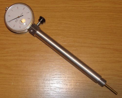

                  If you really want to go crazy accurate about TDC, find one of these (pic)... more accurate than any TDC mark. Will help you find your piston dwell too. You can DIY this tool, just make sure that the spring in your dial gauge is very light so it won't fight the rod and flex it. Obviously one needs to know what one is doing. Insert it ONLY when piston is close/right before TDC and valves are almost closed (as can easily be seen by looking at cam lobes for that piston). This way there is no tool/valve interference.
                  I actually found that my factory TDC mark was off my a hair (to the block). That aluminum cover and its TDC mark is way off due to it being flimsy.
