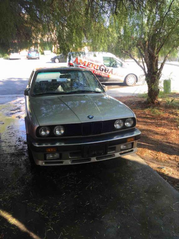

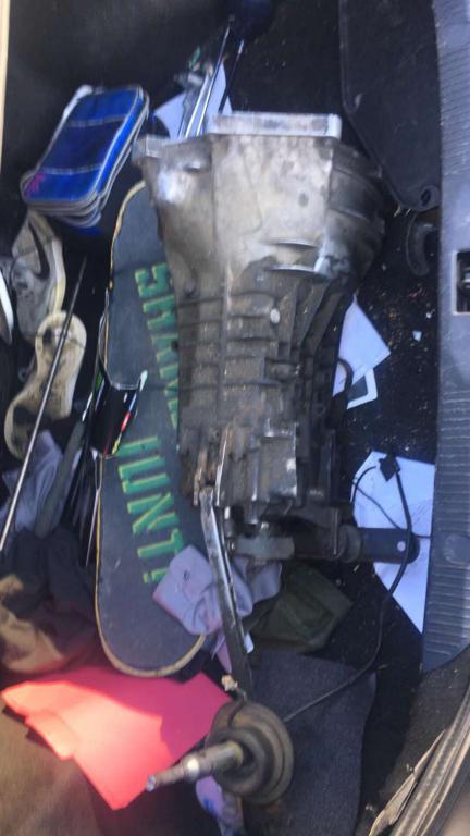

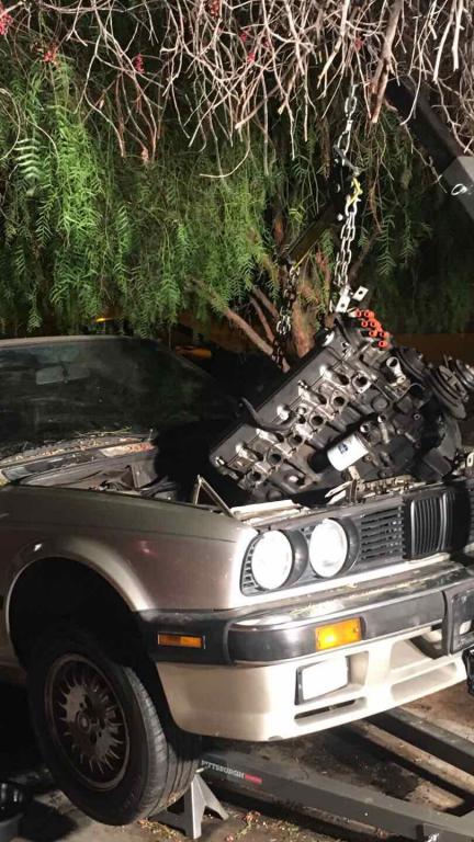

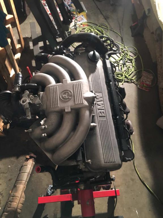

    I already have the Transmission and pedals what else to I need?Click image for larger version
