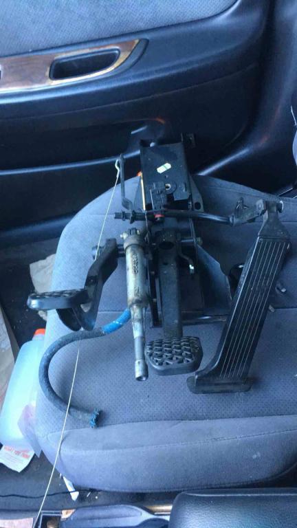

          Here’s the pedal assembly.

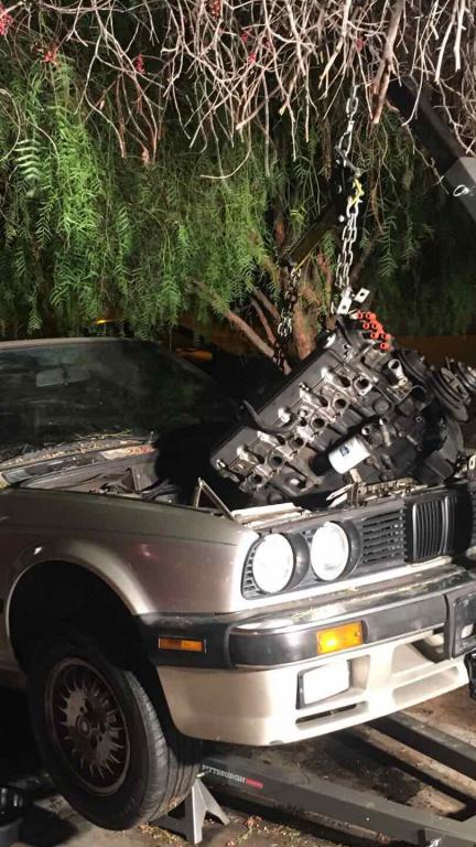

                    That front lift point looks like it needs a day off :eeek:
                    What did you use at your other lift point? Rear of the manifold? I can't tell...
                    Also, how's the swap going? And btw it's not impossible to do it without removing the whole engine. Might even be easier.
                    Here's this guy doing it: https://www.youtube.com/watch?v=ejpE5eZkga0
                      I have two engines. Had to remove the original one because of cylinder wall scaring and bad rod bearing. I may rebuild the bad engine later to learn more. So the engine you see is a working engine with 70k miles (according to the seller). Here’s a pic of the pull I’m having someone more experienced help me. I was out of town this weekend to skydive. So no progress yet however I have everything ready to go! I’ll definitely keep everyone posted. I’m so ready to drive!Click image for larger version
