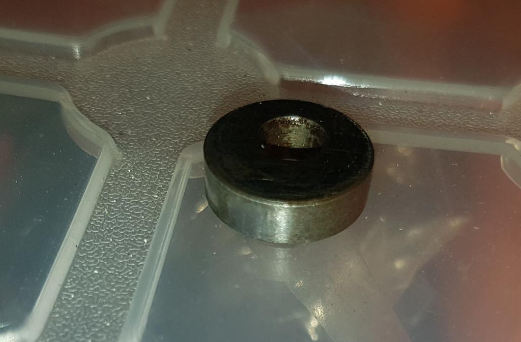

                Righteo well I finally got a chance to fix this up last night. Poor old bmw has been sitting for a few weeks unloved due to a new daily driver...
                Anywho, got it all apart, set it up to adjust cylinder 1, and i couldn't actually get the eccentric to tighten up at all on 0.25mm anywhere I put the eccentric. Flipped it over and no difference.
                At my whits end i grabbed an eccentric off a spare head (unknown km's) put it against the eccentric off this head and this eccentric didn't appear to have any major noticeable wear. Though i didn't measure it was just by eye. but they looked pretty much the same...
                So I put the eccentric off my spare head in, and immediately I was able to adjust it properly to 0.25 with eccentric in the middle of the valve like it should be, and like the other 11 valves....
                So it seems i guess the old eccentric was worn out. I had read rumours of "flat spotting" on the eccentrics but i was looking for a significant spot. it seems the flat spotting is significantly less wear than I was expecting. Anyway here is a photo of the naughty apparently flat spotted eccentric. maybe it is worth buying 12 new ones? the rest adjusted fine, it was just this one.
                Also i made a spanner to take off the fan and took the radiator fan out with the shroud and that made it easy to put my socket on front of the engine.
