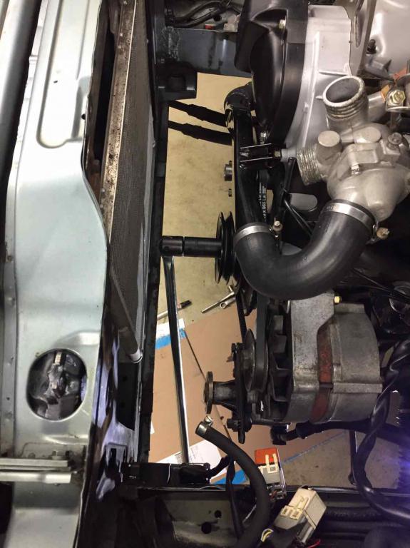

    The last time I needed to torque something past the range of my wrenches I recall doing a calculation of my personal weight times the length of the cheater bar and standing on the end of it. Access is not quite so good here, I was doing wheelbearings last time, how are you all going about torquing the crank nut to 300?

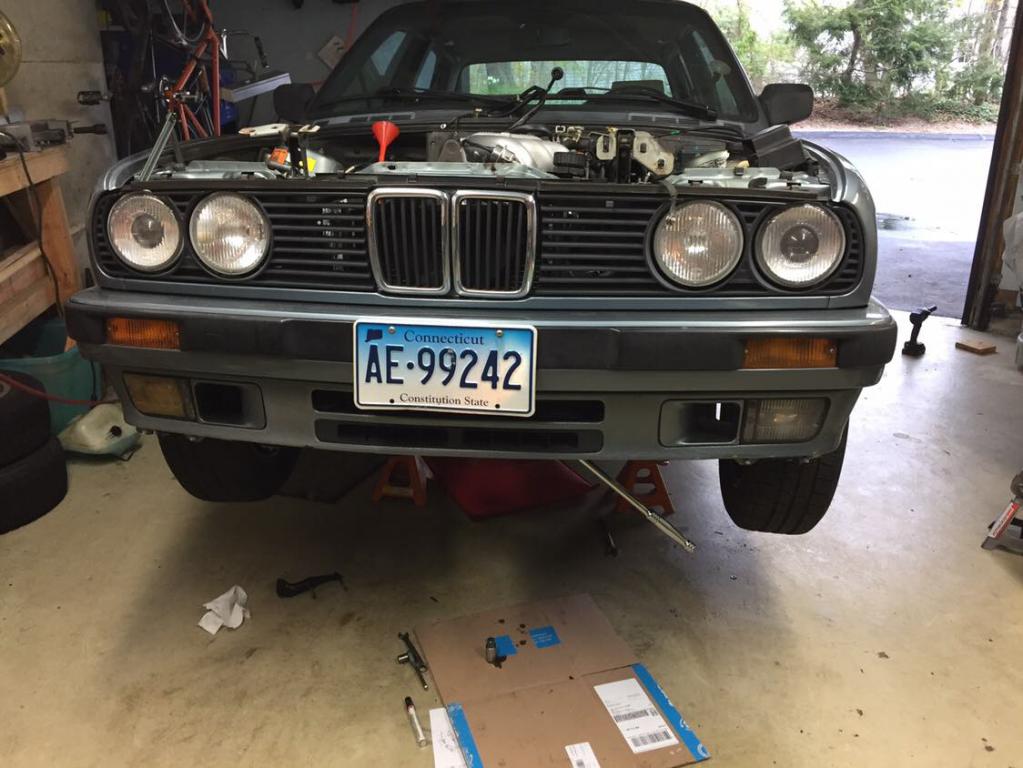

      I now have the car down on its wheels, in gear, chocked, e-brake on and still I'm having trouble torquing the crank nut. I guess 300 ft-lbs wants to make stuff rotate :)
      If I understand the crank holder tool correctly its supposed to be mounted with the pulleys removed? Has anyone used a flywheel holder type tool on the toothe'd ring?

        We have a runner... tried to post a video but no can do. All I can say is: buy the crank tool. Had to fab something up and it was a bit scrapy.
        Didn’t have time much much more than a test fire but happy to hear her purr again

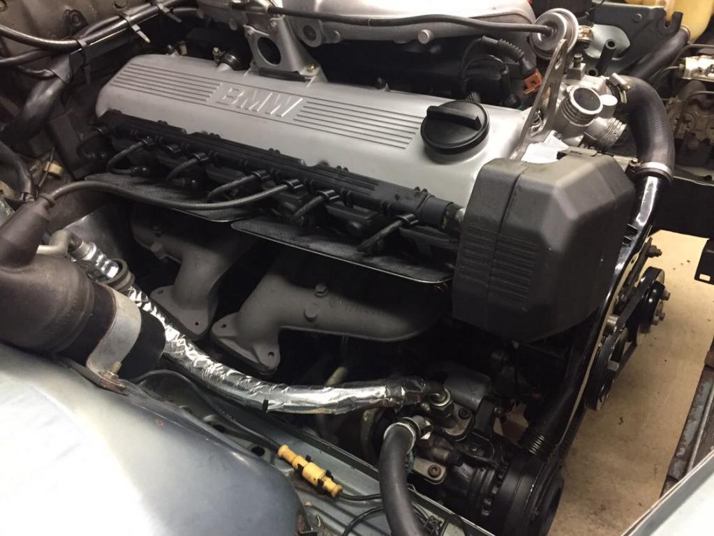

              Any issues getting the harness back on?
              I recall a question about the CPS sensor wire and the lead off the spark plug.
                I posted on another thread. Basically its #6 pass side, cps driver side. The only snafu i hit was i didn’t have the dme bigass connector seated right. Never messed with one of those before and it felt seated but wasnt. Listen for various snapcracklepops under hood with key in run. Took a good 45s cranking but i replaced fuel filter and all rear hose too so empty fuel system. I had cranked w fuel n dme relays pulled to build oil pressure before. Btw those relays showed some heat discoloration, ill probably grab spares for the glovebox.
