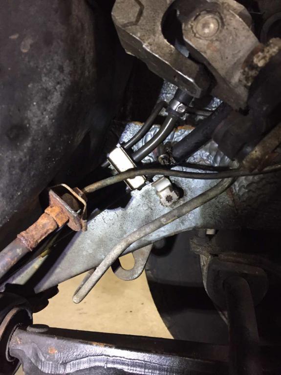

              The parts diagrams dont seem to show which fuel line is supply and which is return. The labels I put on the lines before removing dont tell and photos dont show all together.
              Anyone recall which line the bottom one is?
                [ATTACH]127333[/ATTACH]
                the big one on the very bottom? charcoal canister
                typically out of those 3 lines in the bracket, bottom one is the supply. But there is only one way to be 100% sure - go and look at the fuel filter near the gas tank. If it's coming from the filter - supply; if it goes into the tank - return

                  Good call and reminder I had meant to change all those hoses in the back.

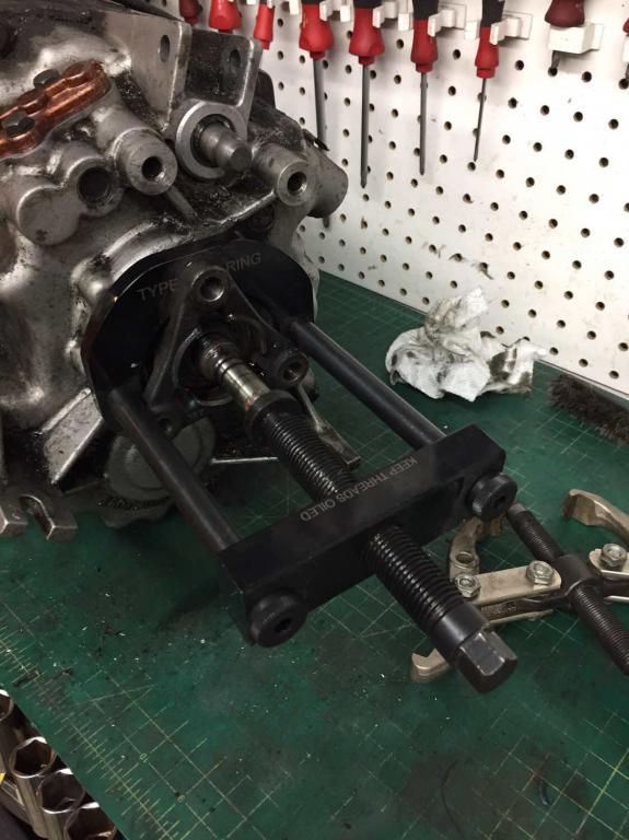

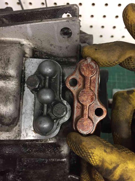

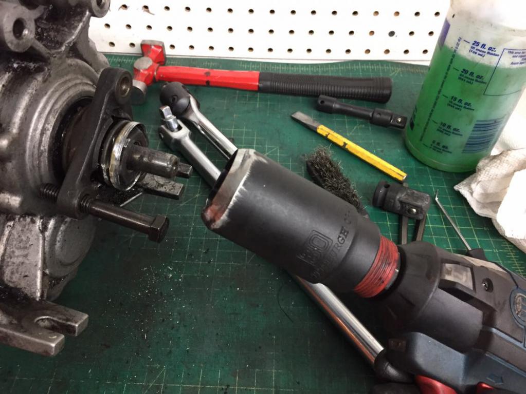

                  Ground down a 30mm and got the trans output nut off. VW crank puller worked nicely to remove the sprocket.
                  Improved detent plate going on.

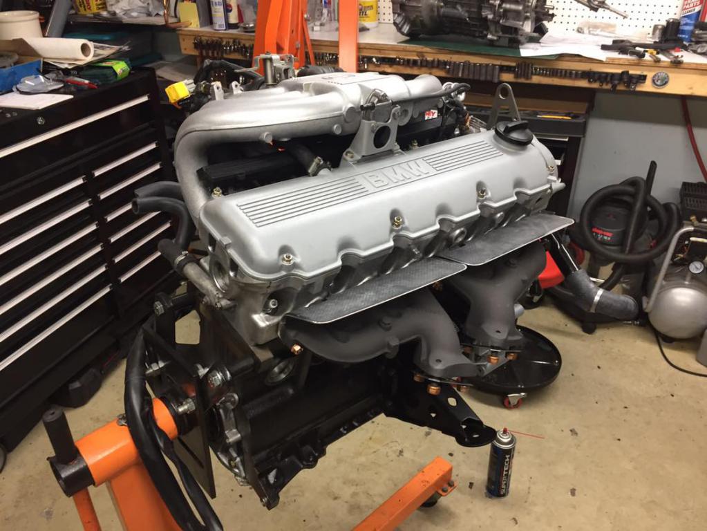

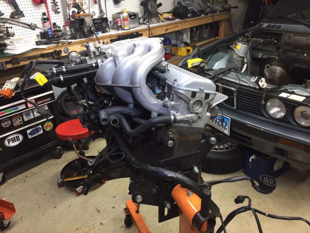

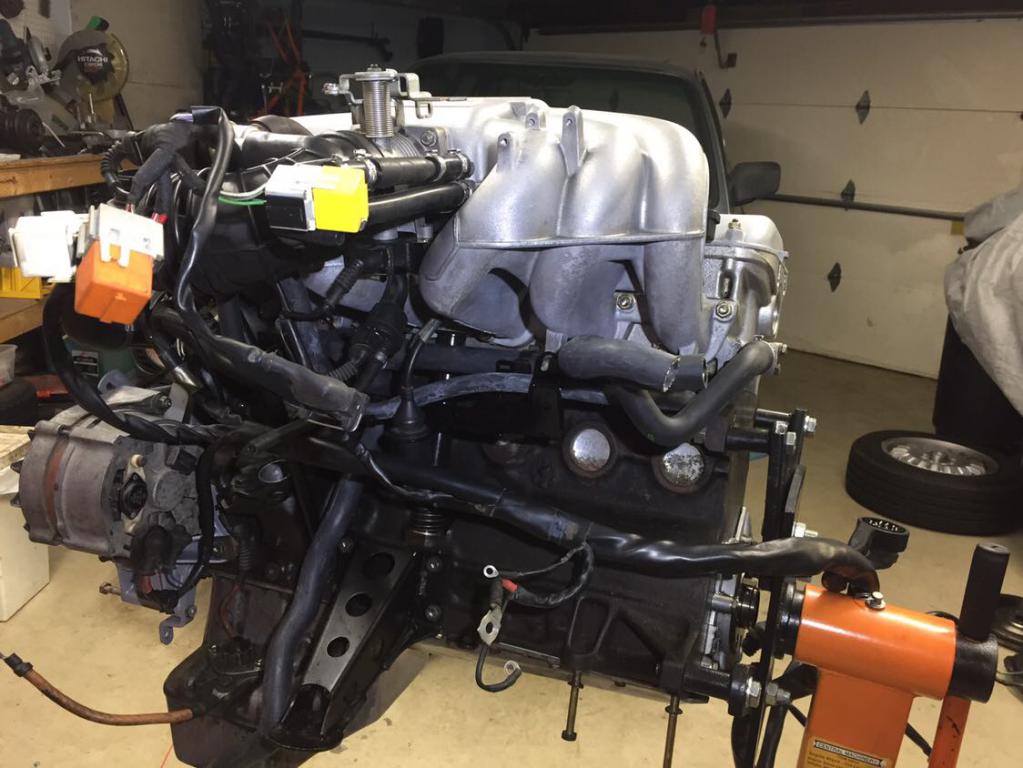

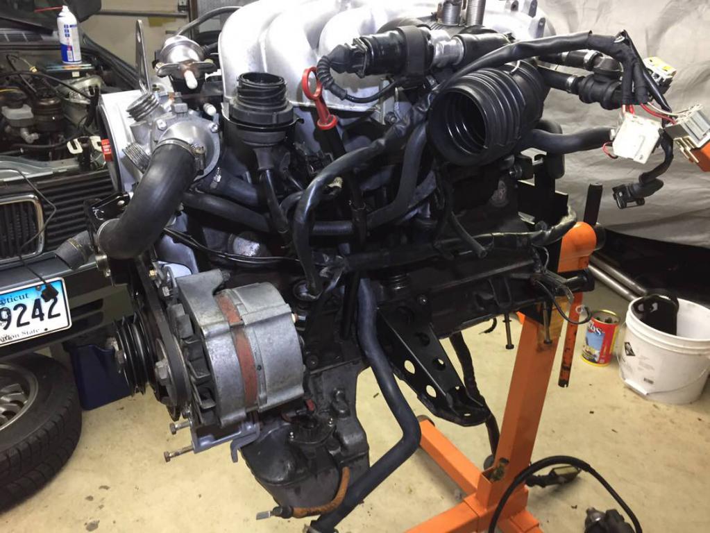

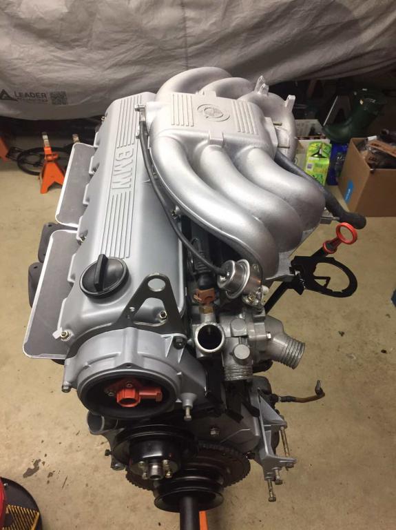

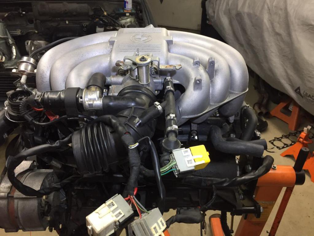

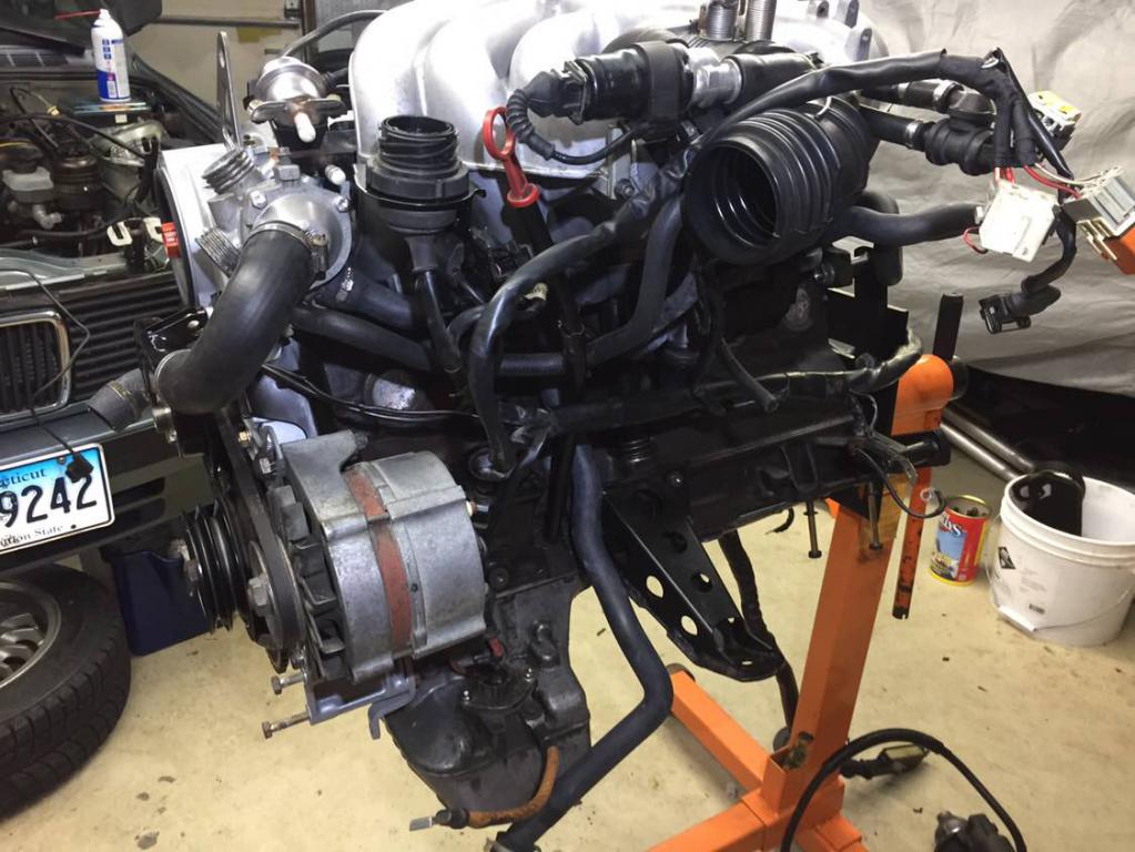

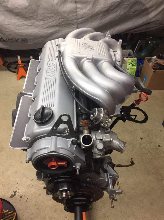

                    Does anyone see anything out of place?
                    Someone remind me if the crank position sensor is closer to the driver or pass side (usa).

                      #100
                      Crank position sensor is on the passenger side. It looks like it's in the correct spot.

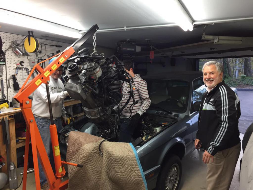

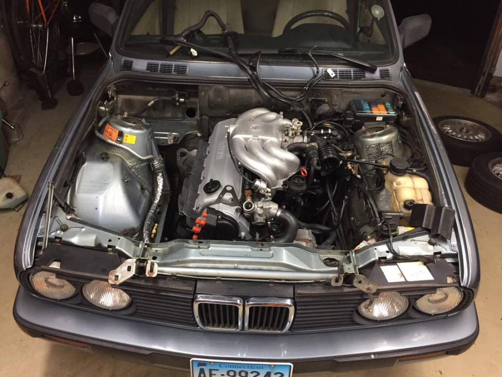

                        #101
                        Back where she belongs. Click image for larger version

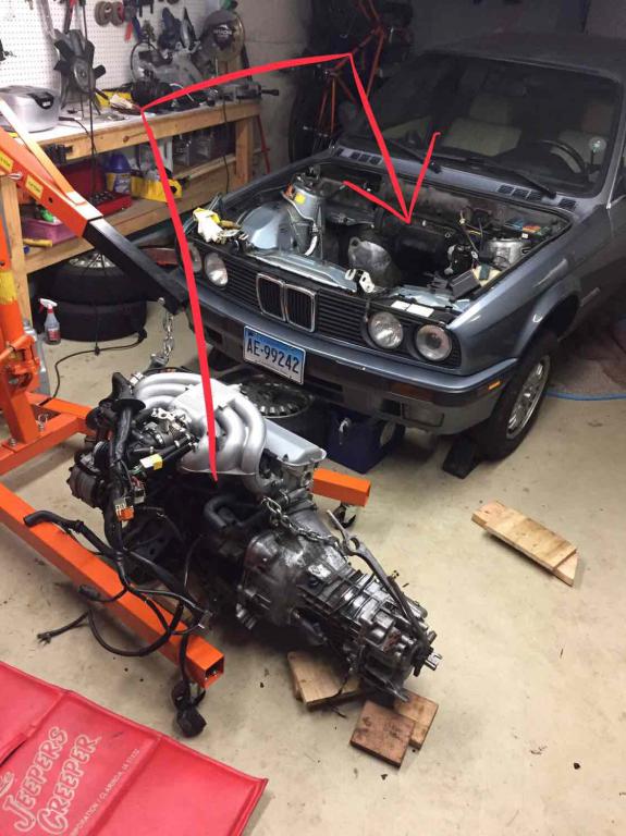

                              #104
                              Time to refresh and upgrade the M20. Looking for feedback on both.
                              For reinstall - I definitely recommend making all your connections on the stand. Easy to forget how tight access is under the int mani. One thing i’d omit is the vib damper / ps+ac belt sprocket. Ac condenser will thank you for those extra inches.
                              I didn’t like the way the rear hoist point pointed the chain at the fuel rail so I figured Id do a test lift with just the front point. At that moment three of my neighbors showed up and we figured we would just go at it. The single hoist point was not a problem (someone can pull the back of trans up to clear the front if needed) but having a good jack underneath the car on the transmission and a person to move it around was absolutely crucial. There was lots of going up on the transmission down on the crane, reverse etc. definitely some bear-hugging and pry baring at the end to get the mounts seated but without a doubt having the carriers on the motor, mounts on the body is the way to do it. Don’t forget that the mount studs can be pointed where you want them more easily than the drivetrain can be.
