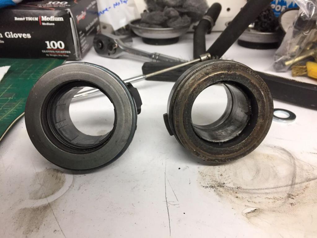

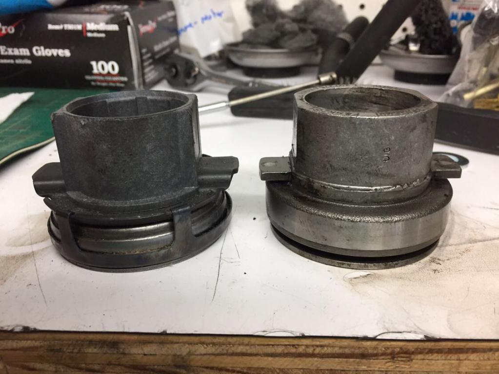

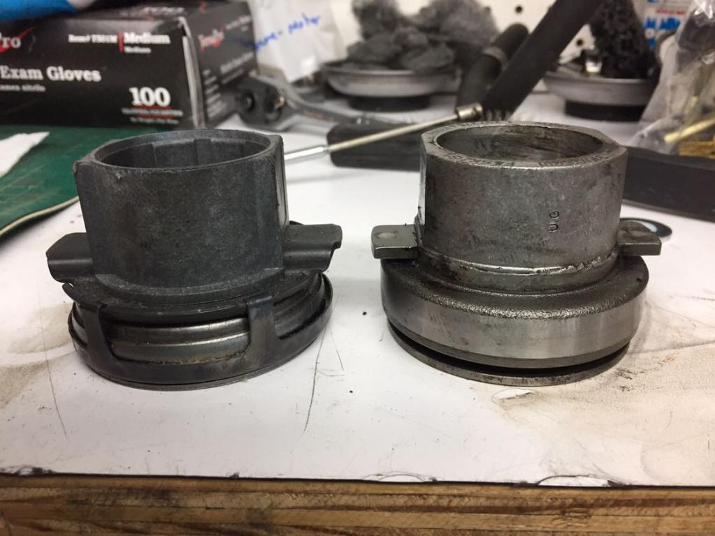

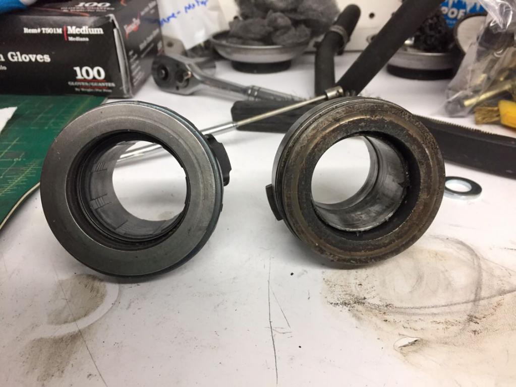

    I noticed the throwout bearing that came with my sachs clutch kit all of which is made in Germany is composite with some stamped components where as the original which is stamped BMW is all metal cast or forged. I also noticed that the FTE made in Germany slave cylinder I received his composite. Is this the way things are going?
ID:	7201381Click image for larger version

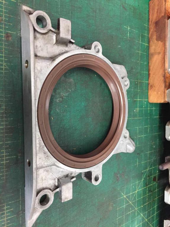

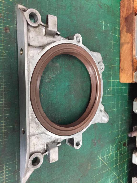

      How did you all go about driving the rear main seal down 1 to 2 mm from the surface of the carrier in an even fashion?

        #78
        [ATTACH]127231[/ATTACH]
        you have to get something of the large diameter. I personally prefer to get this seal and seal carrier as a unit. Not much more $$ than a quality seal and limits a possibility of the installation mistake. You do not want to do this job again soon.

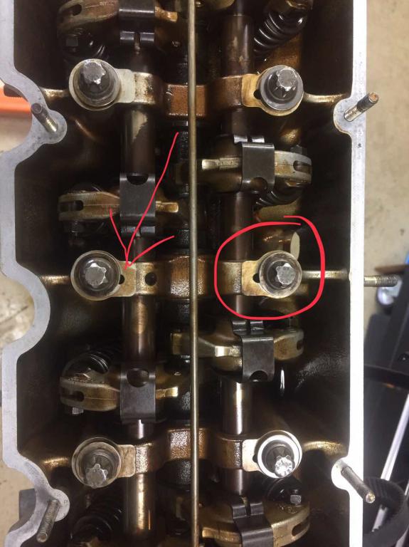

          Is there an intended relationship between the head bolts washers and what I presume are oiling holes? To a limited degree there is some ability to bias the washers one way or the other

              #81
              no those oil holes are nolonger important when the shaft is installed as they are isolated
