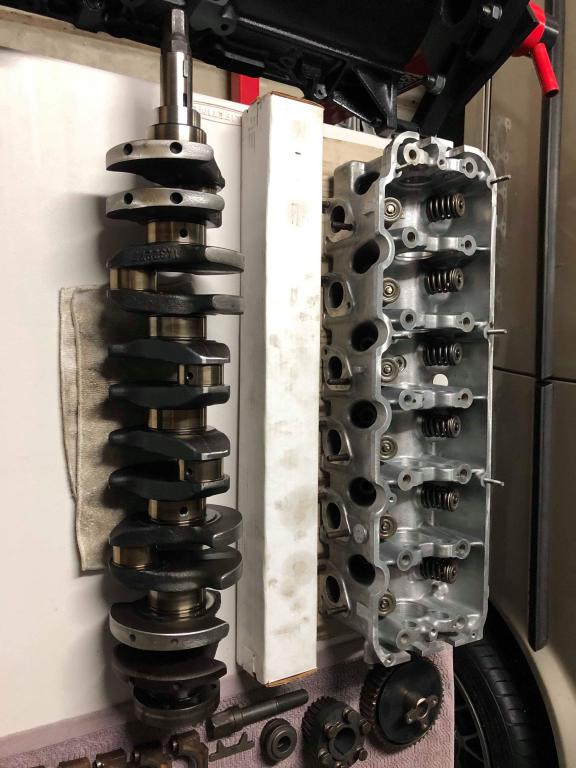

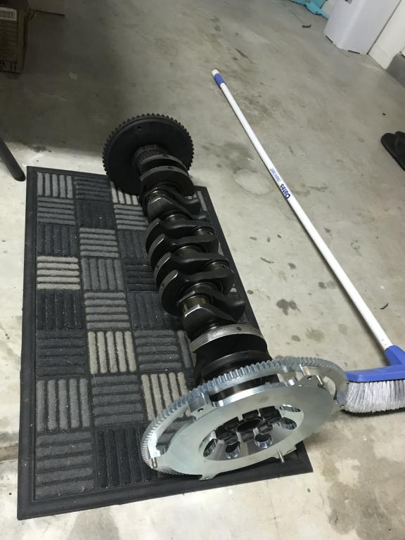

    The plan: M20b25 (1989 - e34), M52b28tu 84mm 328i crank, 130mm 320i (heavy af) rods, b25 stock pistons.
    - Crank spacer machined and fitted to crank snout
    - Piston skirts trimmed flush
    - Crank weights turned down and trigger wheel removed

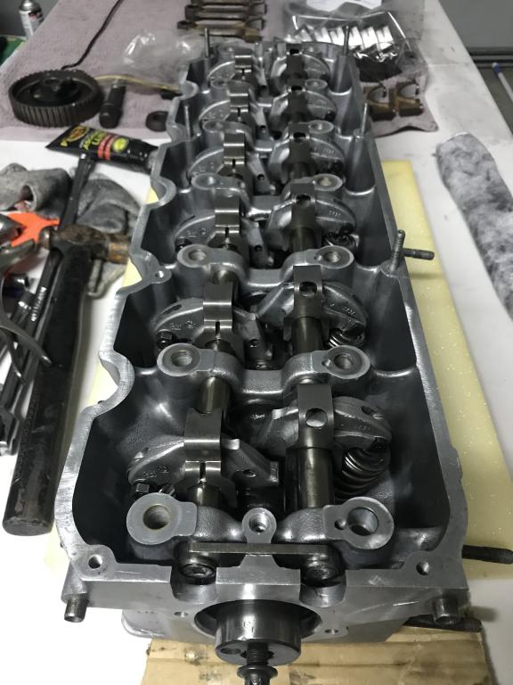

    3. Using stock springs and rockers, they are both in near new condition and rockers were inspected for porosity and bad castings, all clear. Am I pushing the limits not moving up to beehive springs or HD rockers, how high is the risk?

    Crank Spacer, machined using schematic from e30zone, made a batch of 5 and on sold the remainder

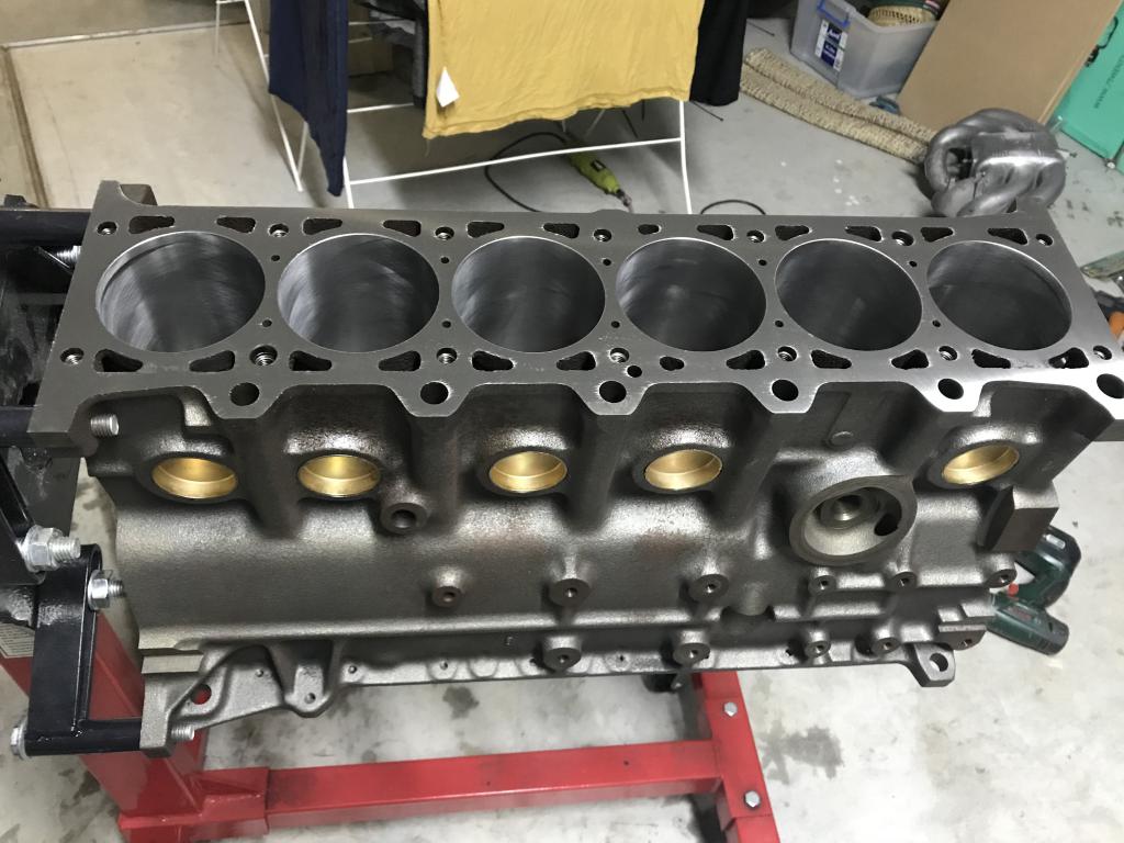

    Midway through the head being rebuilt, the original head was discovered to have a crack through the water jacket into the combustion chamber. Another 885 head was sourced...and also discovered to have an even worse crack pictured above.

      Sketched up these eccentrics, they are 2mm oversized, 18mm compared with 16mm stock, not sure to go ahead with these, or go lash caps.

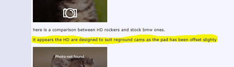

        Looks like you are well on your way. Are you going to get the used rockers re-surfaced? It's not common, but I have heard of people doing it. Otherwise, I would get new rockers. It would be a bummer to wipe a cam on a nice build like this because of used rockers. When buying rockers, it's only about $100-$150 more to upgrade to HD rockers, worth it in my opinion for the piece of mind.
        Originally posted by 2mAn

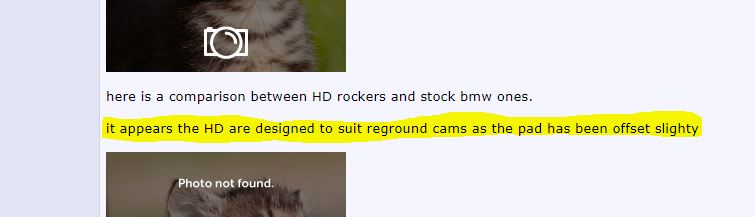

          The HD rockers are slighty different geometry to work with regrind cams if I recall. Alternative is to buy oversized eccentrics
            Not planning to resurface the rockers (didnt know it was an optiong tbh!), was hoping they were in good enough shape to run as is without problems.
            Although there will be increase load on the rockers and springs..hmm
              Tried to find out some more information on this Digger and ended up on another of your threads
              I have a fair amount of gap between the stock eccentrics and the valve, may need additional adjustment even if the rockers are suited for reground cams.
              Thinking I may stick with oversized eccentrics as lash caps don't feel like the right solution to the problem.
              Thanks for the heads up, btw your stroker posts definitely inspired this build!

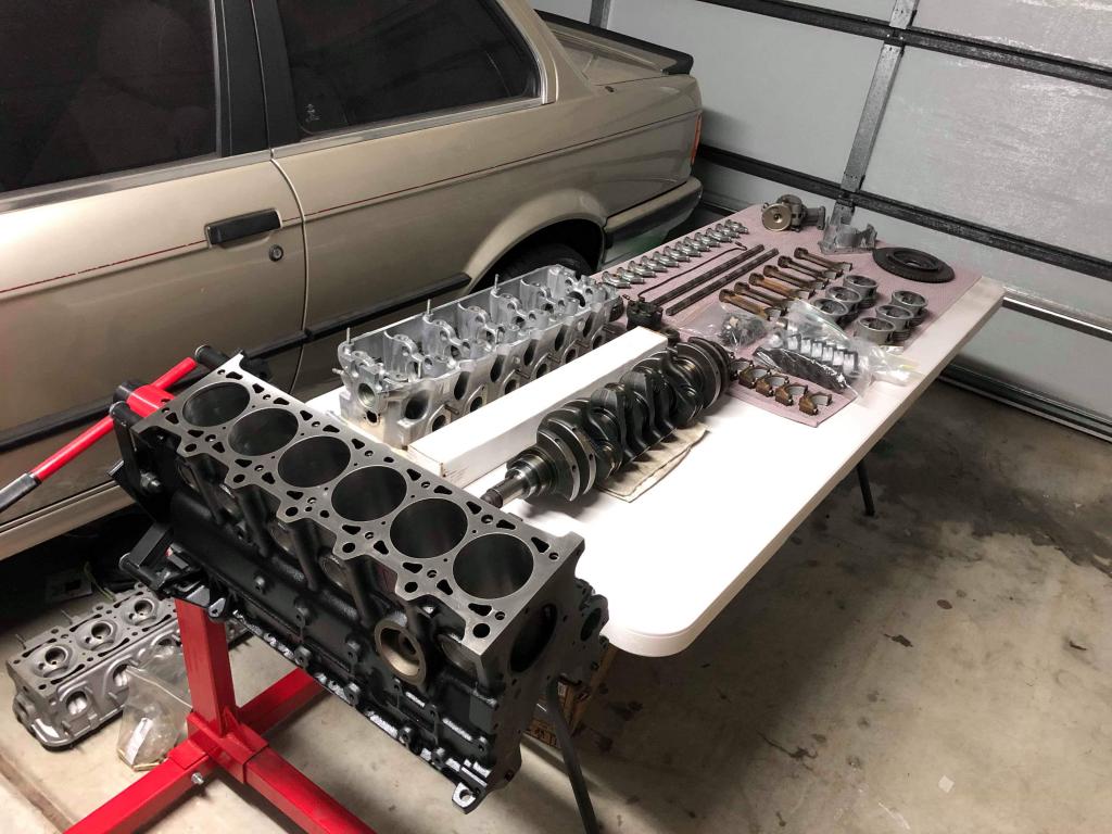

                Guys, the head and block have been skimmed 0.5mm from the stock stack height, assuming a stock HG and 284/11.05mm lift, piston valve reliefs have not been touched.
                Before I get too deep into reassembly, whats the likelihood of running into piston valve clearance issues? Should I have the reliefs enlarged/deepened?
                Also any information on how to convert the engine to a non-interference similar to Metric Mechanics, is it just oversized reliefs? Assuming there isn't enough meat on the 8.8 pistons to allow for this?

                    there is about an extra 1mm of the clearance taken up by the looks of it.
                    i would have pockets atleast deepened and perhaps +1 on inlet to allow bigger cam and better head later on though yours would probably be ok as is with current cam and stock valves.
                    set the piston to head to 1.0mm +/-0.1mm to get the correct deck height. IMO do a quick mock up of 1 and 6 with bare head and old gasket.
                    i wouldnt worry about making it non interefence its unlikely you could on stock pistons and it compromises the combustion chamber. Really just use good parts and adhere to the relevant maintenance intervals and you shouldnt have any issues if you check the piston to valve clearance.

                        Did you balance the crank after cutting the counterweights ?

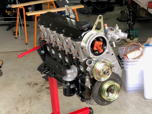

                          Back from the dead!
                          Managed to button up the engine and confirm clearances were all satisfactory, its now partly dressed and ready to go back into its home.
                          Working on the exhaust headers which became slightly warped after ceramic coating, due to the individual header flanges allowing movement.
                          Considering swapping to a Gates Racing timing belt, while its still out of the bay, still undecided.
                          Engine has been sitting on its stand for way to long now waiting for engine bay to be brought up to scratch. Rust repairs suck!

                            Sure did!
