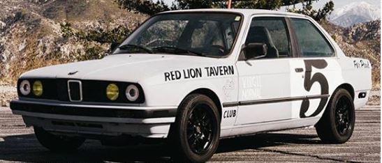

                      here's a pic from his ad a year ago.
