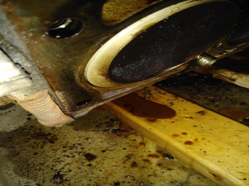

      looks like seta slugs which are b25 but valve reliefs smaller. Can you put cylinder 1 at tdc and take pic so we can see if it sits low w.r.t deck
      • turbski
        • Jul 2018
        • 329
        At top dead center the piston protrudes a bit. What is w r t
        • turbski
          • Jul 2018
          • 329
          With reference to? Lol super slow I am
          • digger
            • Nov 2005
            • 6198
            Yeah I mean the edge of piston not the very top of crown
            • turbski
              • Jul 2018
              • 329
              not the best but shows how far the crown is out of the block and the edge of the piston as well if that's what your looking forClick image for larger version
              • digger
                • Nov 2005
                • 6198
                Yeah pretty certain it's a SET
                • turbski
                  • Jul 2018
                  • 329
                  all the research ive done along with measurments seem legit, thanks for helping to verify. big help. off to the machine shop it goes!
