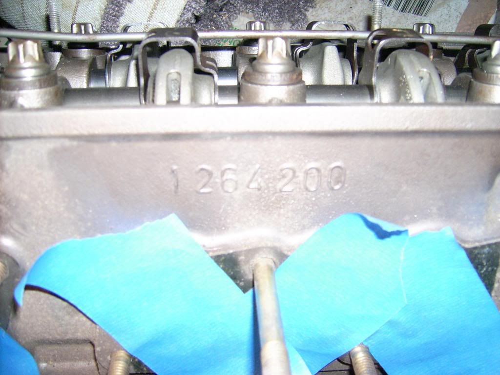

    -The head casting # ended in "200". That's an eta head. If he had a "high performance" m20b27, it sure as heck wouldn't have an eta head, even a ported one.
    -And +1 to the s-eta having an "885" head casing number. I should know ;)

          it's an e. only 4 of the cam journal oil passages are drilled.
            Damn. I had kind of accepted that it was an e, but I was still clinging on to that last little bit of hope.
            What does that mean?

            • nando
              • 34839
              it means you have an e cam, head, and valve springs with a ~5k redline :p
