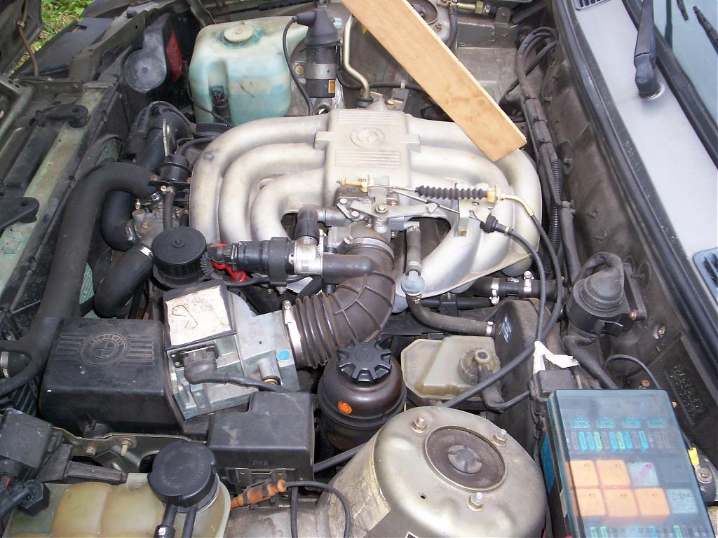

My 1986 325es has the stock 82-87 325,e,es (Crank, Rods, Flat Top Pistons, Port matched head, and i cam(Note 6)) with 1.3 Motronic Up-Grade.
Everything else if from an 87-92 325i,is,ix 2.5L 1.1/1.3 Motronic
(double valve springs, valve cover, duel exhaust, intake manifold, throttle body, injectors, AFM(air fuel module), FPR(fuel pressure regulator 3.0bar), all pulleys(fan, water pump, crankshaft), alternator(90 amp), belts, thermostat housing, 173ecu(computer in glove box), all 1.3 Motronic wiring and sensors, coil, wires, plugs, fuel tank, fuel pump, fuel lines,flywheel (lighter), transmission (better shifter design), starter, drive shaft, differential (4.10 from a 325ix)).
