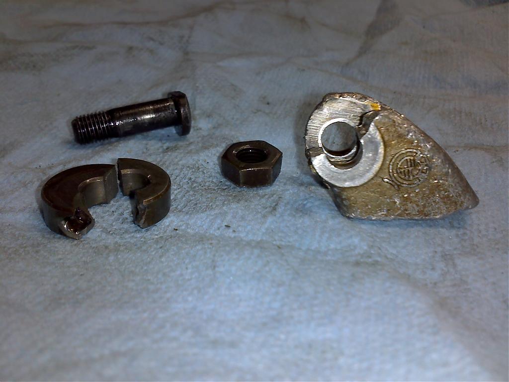

Thanks for the tip, I think Bee has another head he can hook me up with so I can get that rebuilt and just swap them, would that make sense?
Broken Rocker
replace the rocker and you will be good to go well until you break another one ha.

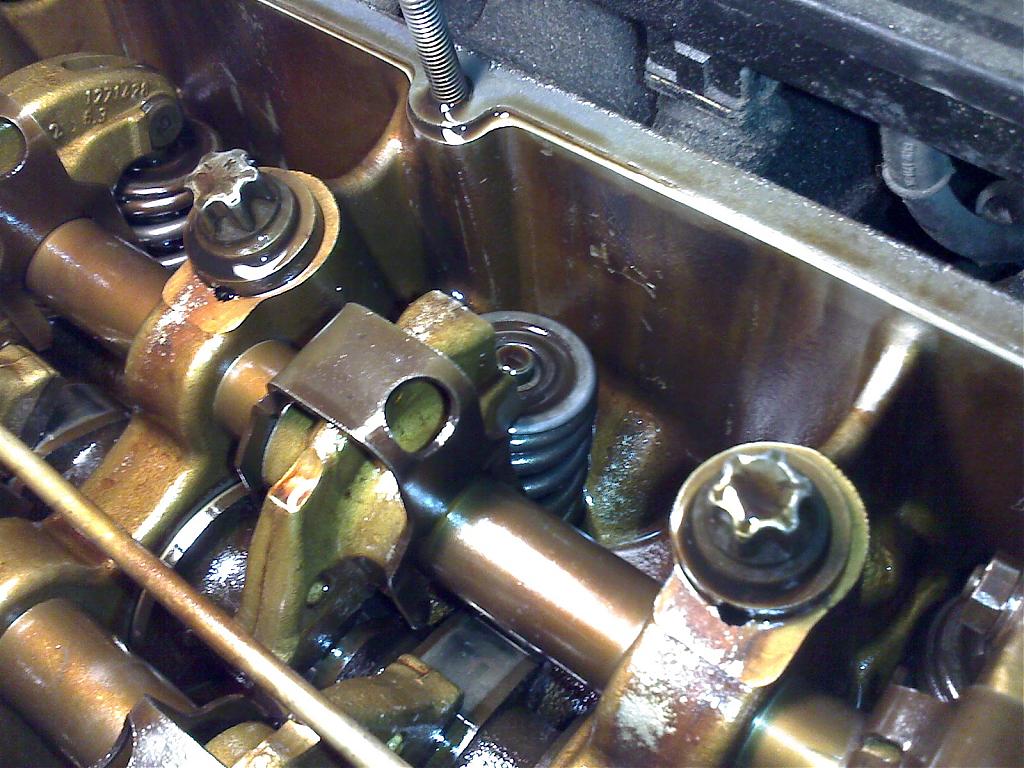

Is there any way I can see this picturee number 5 decide d to split on me.
I had the same problem on my e30 the #3 rocker arm on the intake side broke. I would replace all the Rocker arms on that side not just the one that broke. If you have a broken rocker arm on the intake side you DO NOT need to pull the cylinder head to replace it.I am not sure about the exhaust side but on the intake side just tap the rocker shaft out through the cam gear (See photo)

Head bolts from BMA: $26
Head gasket from same source: $26
Peace of mind from eliminating abused rockers on an interference motor: priceless.
Revs break rockers on these motors. Pull the head, replace them all (they all revved the same), and drive it for another 100k.sigpic
