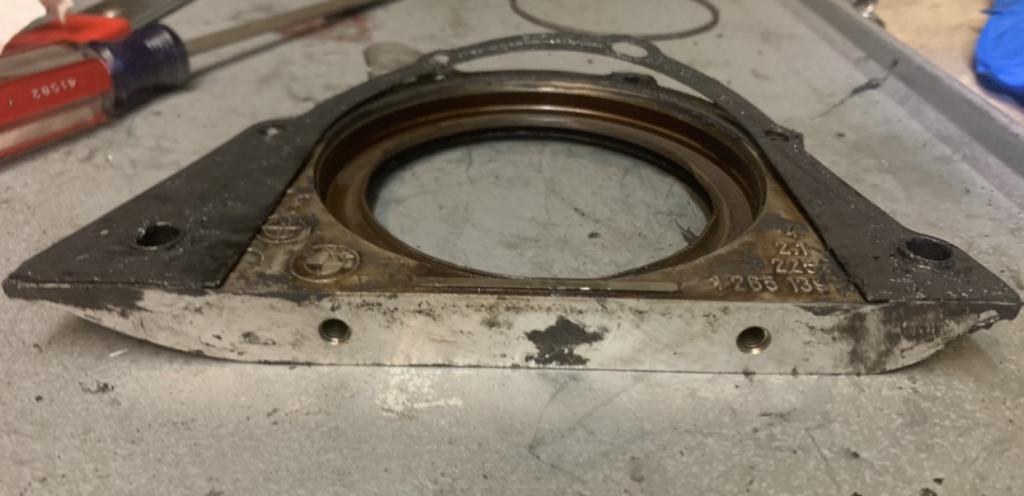

    Rear main seal gasket not sitting flush
    This is the correct item number. I have put gasket sealer on the metal, then the gasket, then more gasket sealer. It is bending when I line up to the bottom holes.
    is this correct?

    i have one here, gasket is klinger OE brand. theres a bit of bunch up but will easily sit flat
      So just slap it on and tighten down? The information I'm seeing - most put gasket maker on the metal, the gasket, and then more gasket maker. Is that the correct procedure? Seems like Bentley doesn't mention that many layers of stuff.
            you'll have to judge if its going to work its way flat. it does/can pivot a bit on the dowel which would tend to reduce the bunched up materialso it wouldn't surprise me if it self adjusts. just make sure you put it on the correct way not like the pic i showed for demonstration purposes.
            its ok to use some goop but you dont need heaps as the metal gasket is embossed to impart high contact pressure. i also like the permatex/loctite non hardening tacky stuff/ aviation cement whatever you wan to call it.
              Thanks. I went and got another gasket from the dealership - fits a lot better than the first one.
