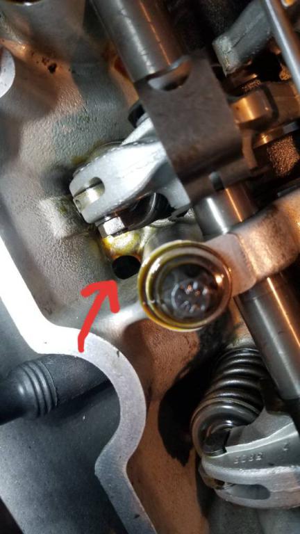

    So I dropped a screw into this hole in the head. Is that the oil channel, and is the screw probably in the oil pan? Thanks for the help!

    Looks like a drain back channel to me. If it's in the pan depends on the size of the screw and if the passages are machined well/the HG is aligned properly, otherwise it could hang up somewhere.
    I'd stick something down the hole and see if there is a clear path down, if so, it's probably NBD as the oil pump shouldn't pick up a screw.

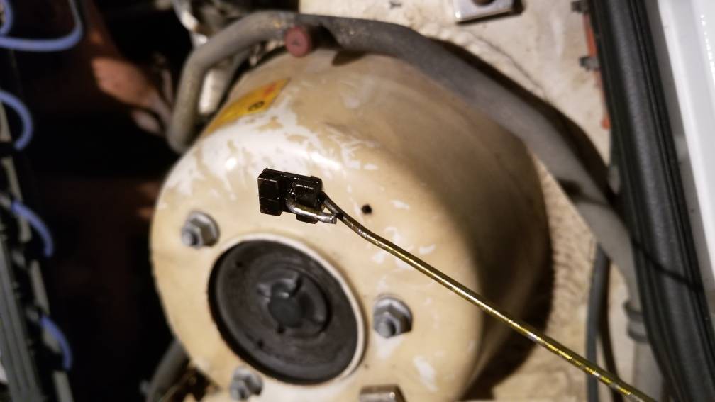

          Good advice guys. I pulled a magnet off an old power toothbrush head and put it on the end of a straightened hanger. I shoved it all the way down to the oil pan, but no bolt.
          Next, I'm going to drain the oil and root around in the pan with a flexible magnet tool on order from Amazon. I'll update this post with how it works out.

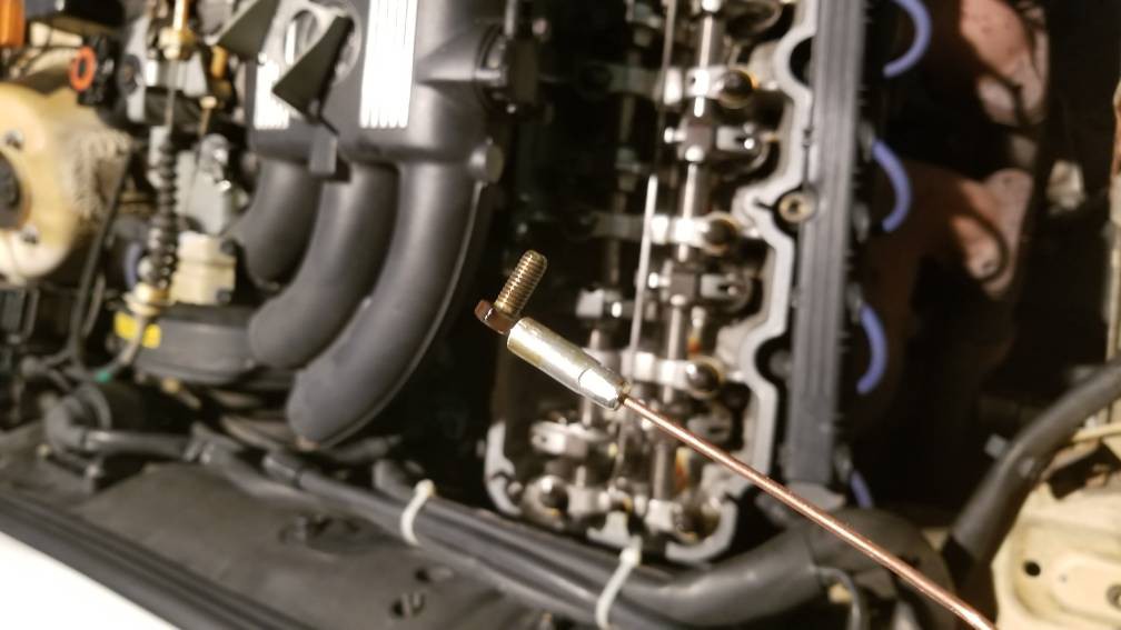

                  I drained the oil and tried to retrieve the bolt thru the drain, but access was too limited. Before pulling the oil level sending unit for better access, I figured I'd try one last time to pickup the bolt from the hole in the head - just with proper tools this time.
                  Hallelujah! I snagged it with a strong magnet pickup tool and out it came.
                  This all started with a valve adjustment and injector rebuild project. The bolt is from the fuel rail mount, and I dropped it during reinstall. Be careful kids!

                        yeah, oil level sensor would be no go.....there is a baffle.
                        Nice catch though...Congrats!!! It's funny how you snapped that pic...holding that bolt above the head...waiting to drop it again :)
