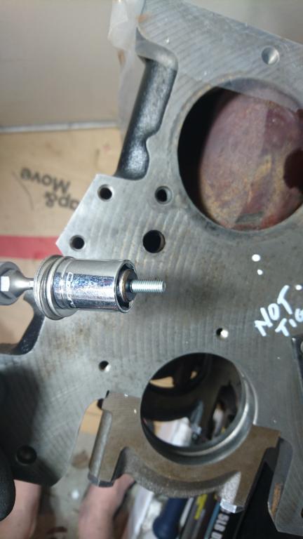

            Thanks guys. My slide hammer is a $30 eBay PoS, so I improvised. Killed a few washers but she's out.
            Think I'll just do the front one, should be good enough for some rigorous gallery cleaning.
            Click image for larger version  Name:	plug.JPG Views:	0 Size:	36.9 KB ID:	9904407
            Going to see if my crappy USB camera on a stick will fit in the hole. Can't really see much atm.
