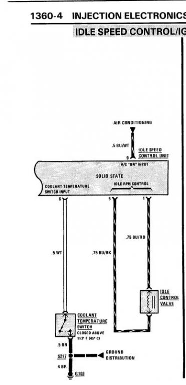

    I also should have asked about the function of this switch. Obviously, it's just a simple open/close temperature switch, but what specifically does it do? It looks like the circuit goes to the DME.
    • varg
      Florida Turbo Man
      • May 2014
      • 3374

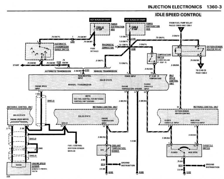

      Can't help you with the source but here it is in a wiring diagram to give you some idea about its function. I don't know precisely how the idle control unit responds to it, but if I had to guess I'd say it switches a stage of cold/fast idle off when it closes. I say a stage because there are other temperature inputs (0°C switch, coolant temp sender) which may be used for an even higher idle after true cold starts.
      IG @turbovarg
      '91 318is, M20 turbo
