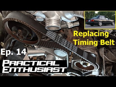

                    Watch this video slowly.
                    This guy didn't bother removing the head, though.
