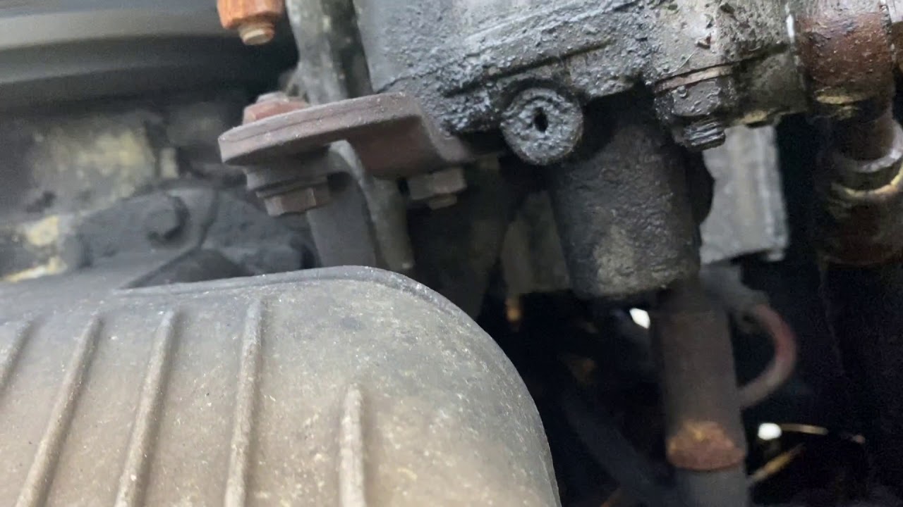

          Got a few videos this morning, only one that would send to my computer was this one. Once it was warmed up completely the noise was pretty much gone. Maybe if I listened to it a bit I could faintly hear it, but very hard to notice after that. Hope this helps. If not I have a few others I took, so I can try to upload those too.
          I posted a video on reddit and someone said they had the same sound and it was low oil pressure, could that be what's going on? I haven't checked under the valve cover, gonna hopefully pull that off this weekend. Might change the oil and pull the pan to check out if anything feels loose on the bottom end.
          Again, any advice helps, I lack the knowledge needed to diagnose this right now.
