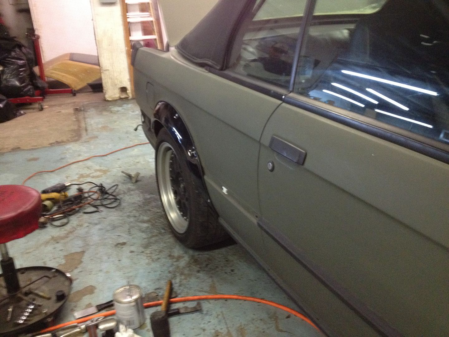

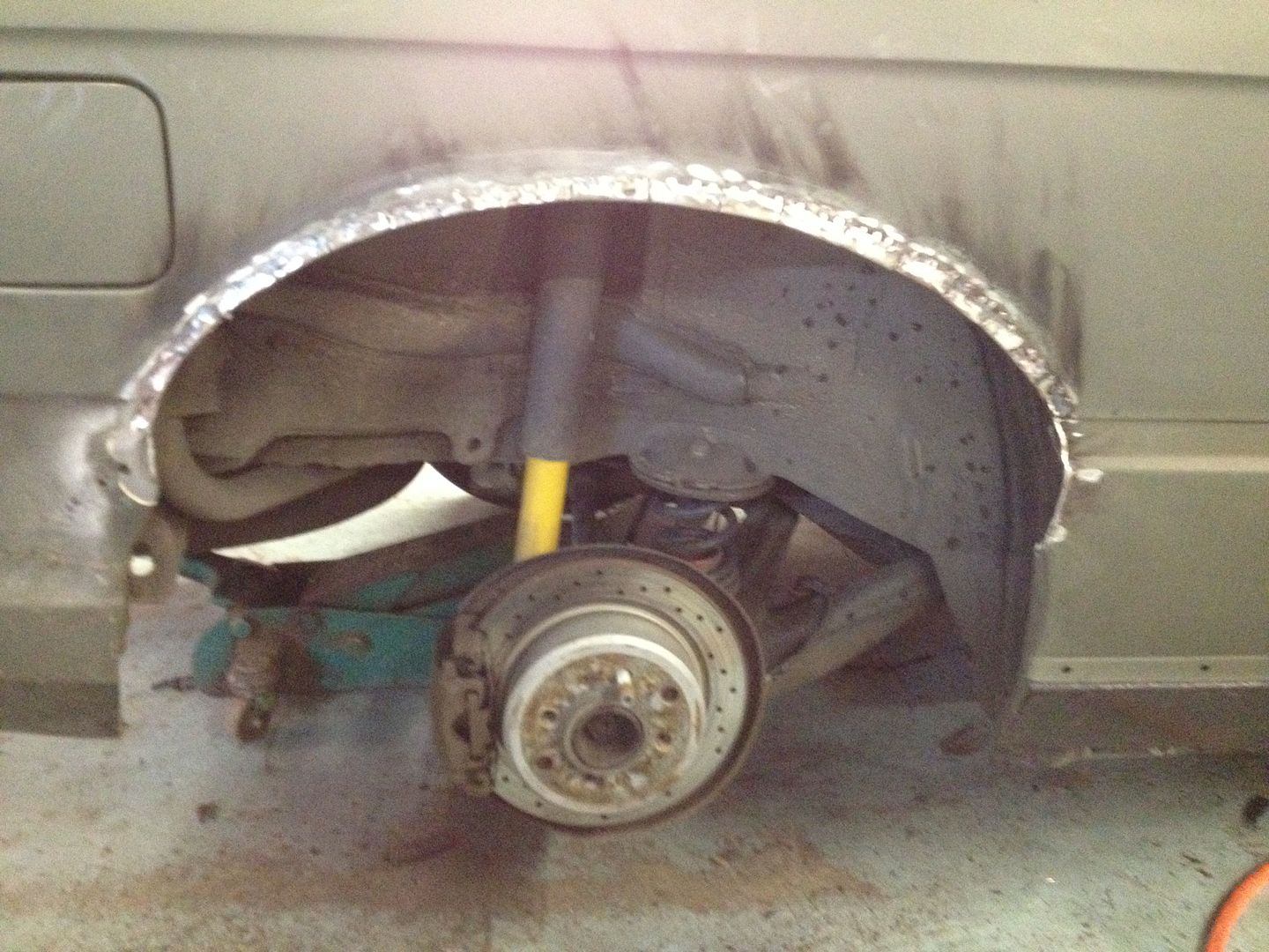

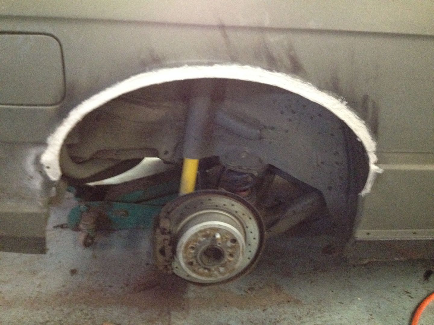

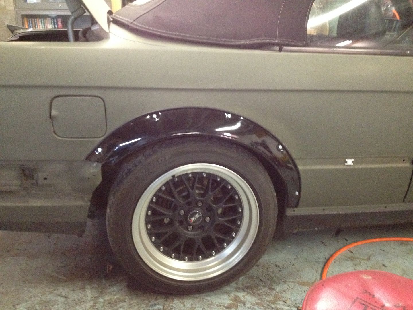

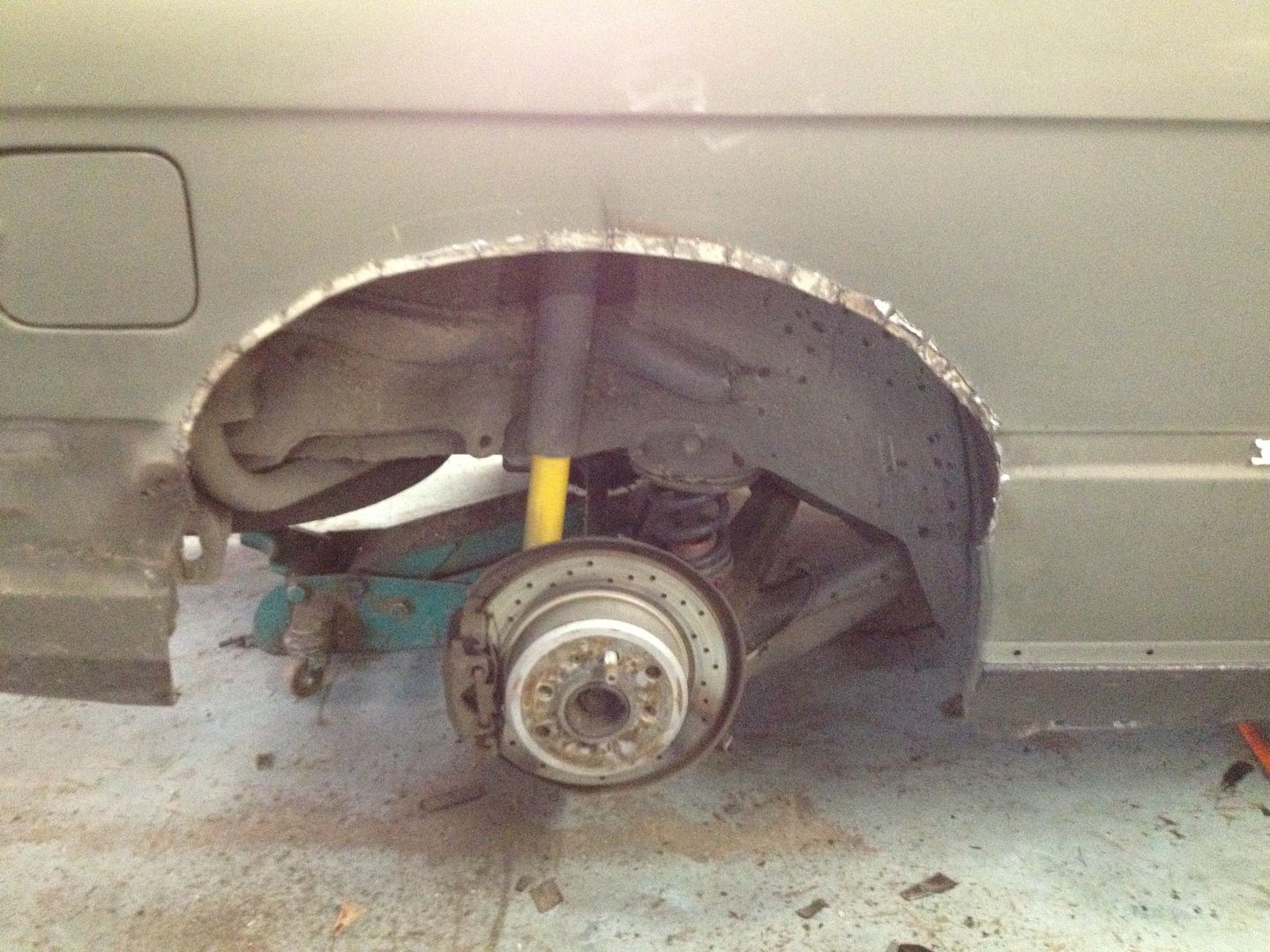

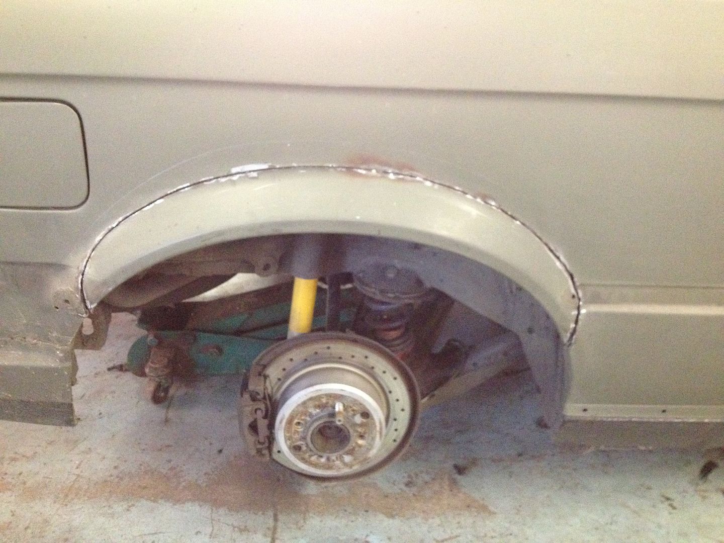

So fender flares got some attention today. I decided to tackle the rears first because even if I ran out of time it still looks cool with rear flares. So I did some cutting and welding and then some painting because shiny parts dont look right on my car.
Eventually the flares will be body color when I paint the car the same color as the engine bay.
And now I can put some much wider tires in the rear and actually be able to experience traction!!! Oh and not the rear can be dropped to the appropriate lowness.
I will let the pictures talk.

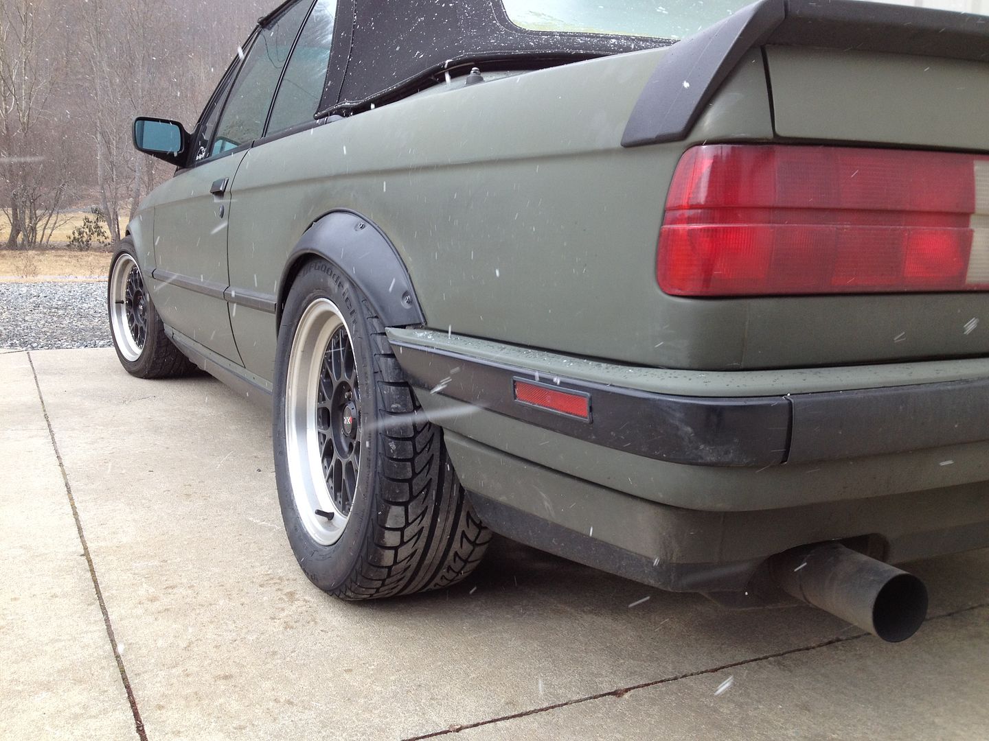

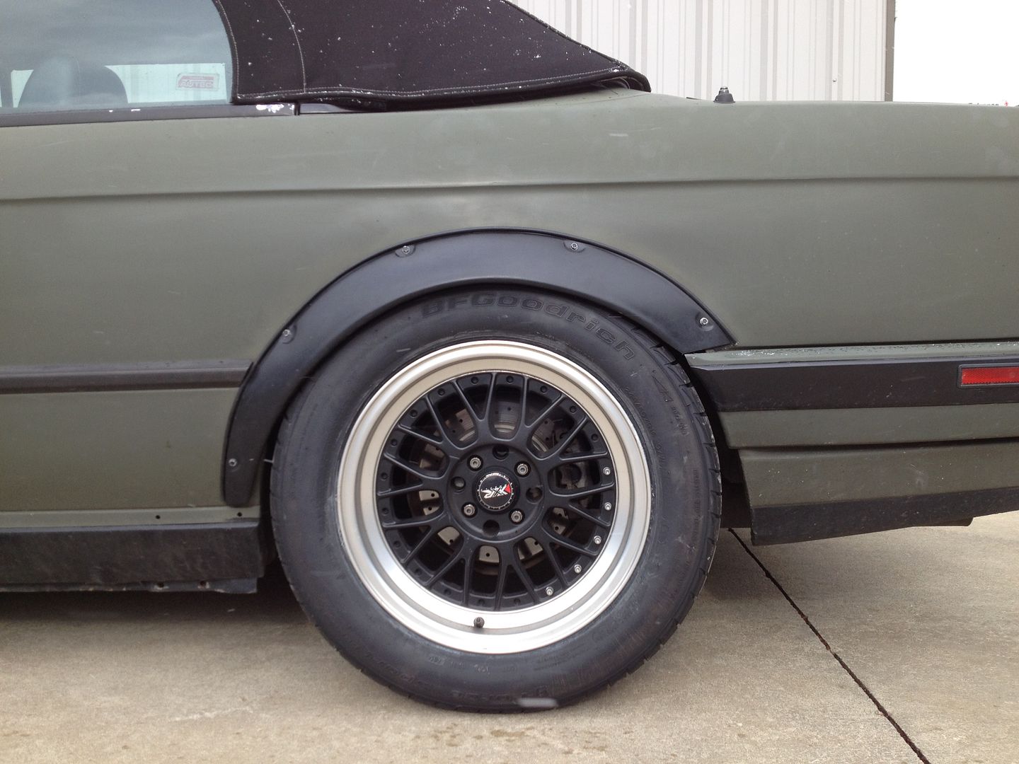

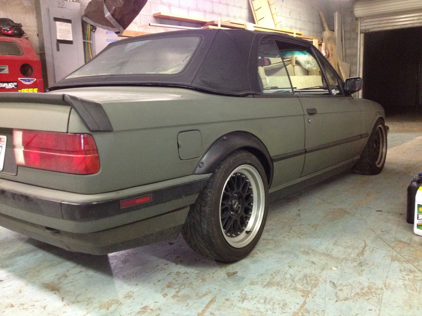

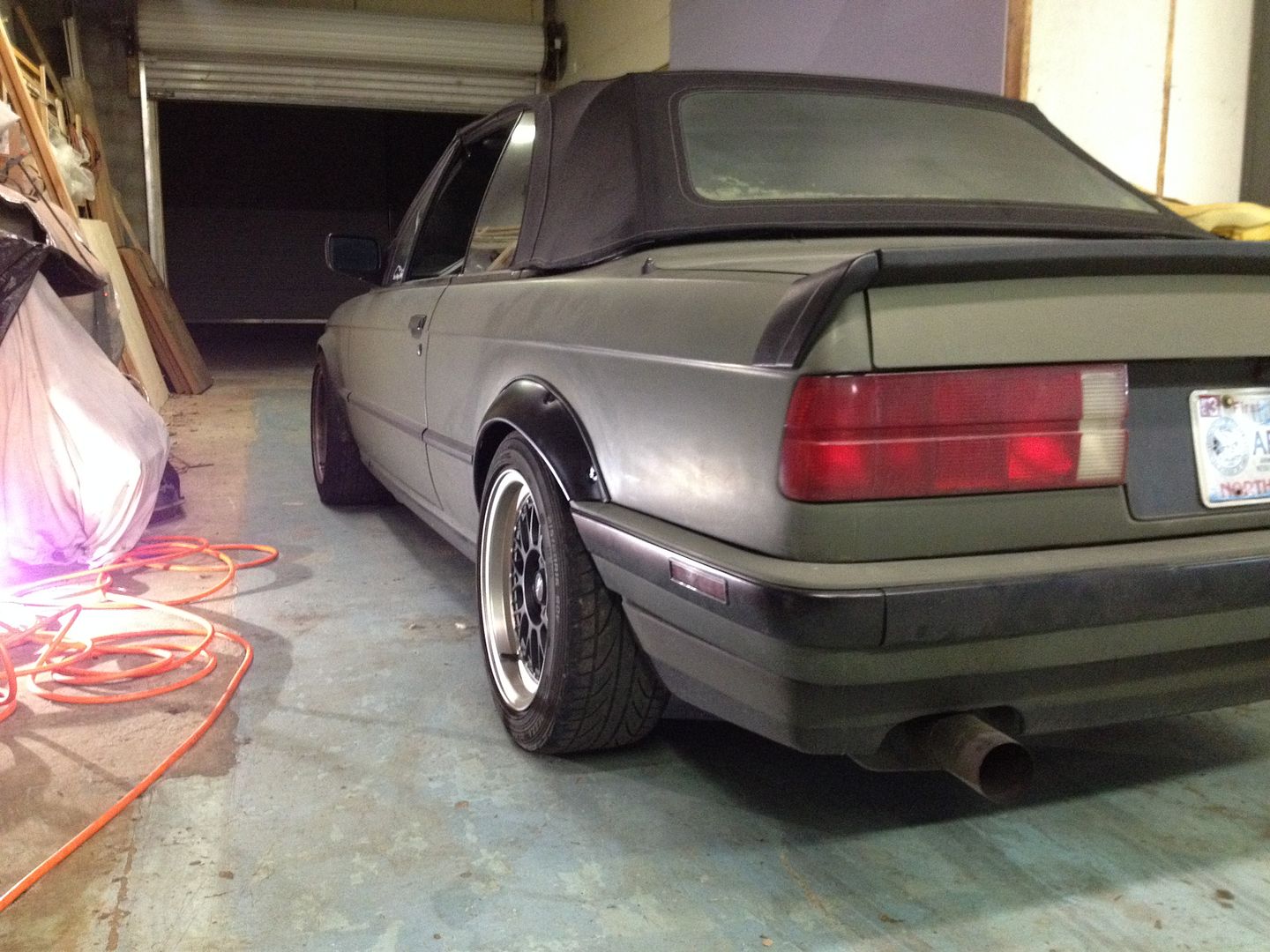

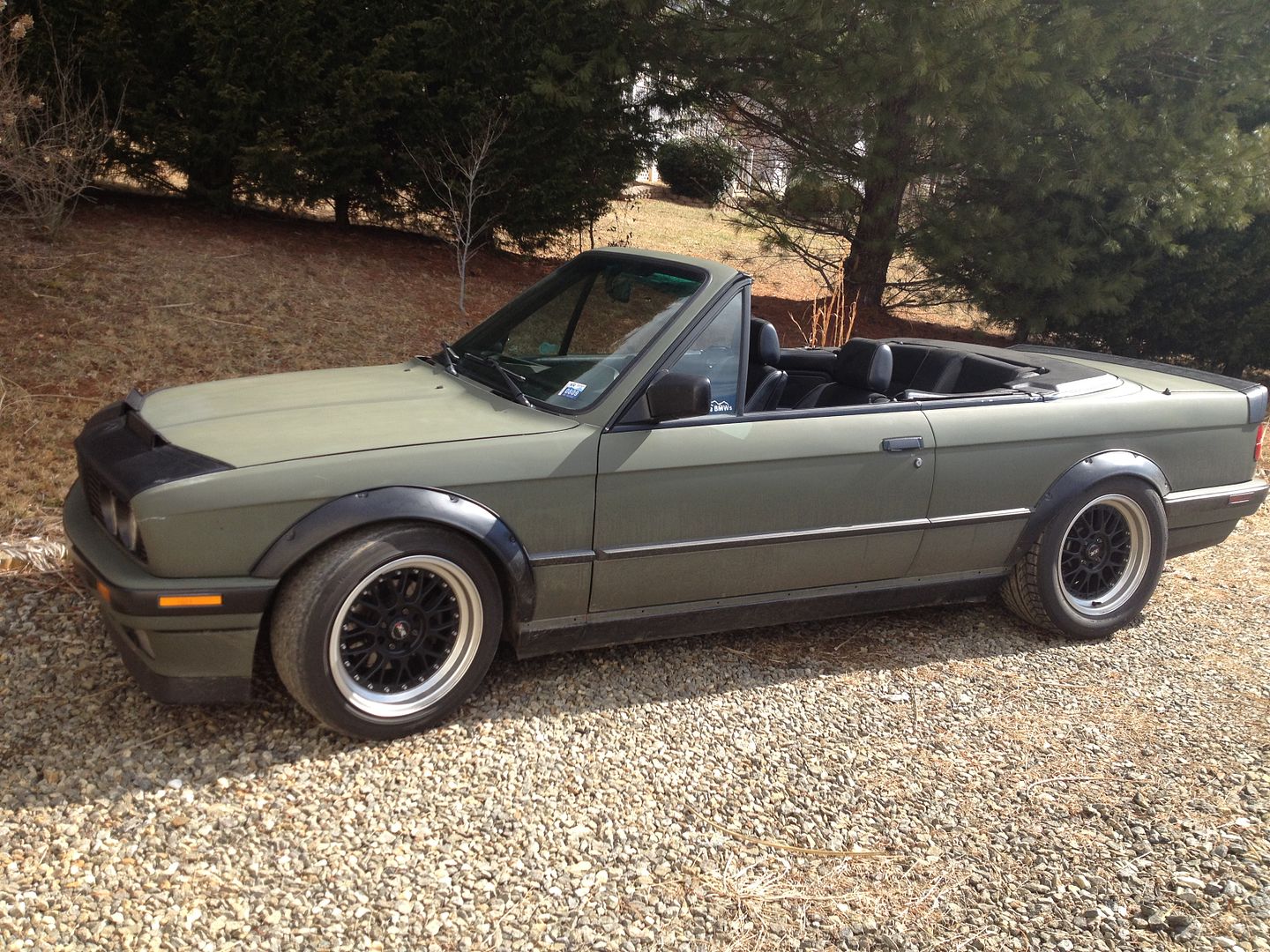

Front and rear flares are done and have been for a while now. Divorce, final semester at college, new part time job, and weekends with the kids have all taken priority. So my updates have been non existent and I apologize.
The car runs like a dream and nothing on the road has been able to touch her. I daily drive the e30 and that blows people away once they see how hard I am in the car. But the more I drive her the better she gets. I have squeezed 245/50r16 under the back and 225/50r16 in the front with the flares. I think it looks pretty mean.
The next thing I need to address is a strange knock in the rear when I take off. It may be my subframe bushings even though they are relatively new and poly.
