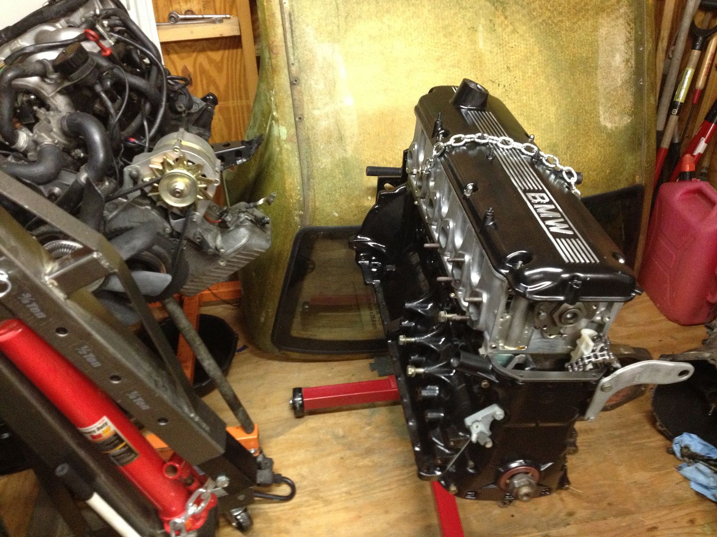

So I have another dilemma. The block is supposedly from an E34 and is a M30B35. The problem is that the oil pump chain tensioner I bought for the B35 is not usable with this block because the boss for the mounting pin is non existent! So I have to use the old oil pump shims. But from what I can see on realoem all the e34s had the chain tensioners. WTF!
Edit: After looking over the block and the lack of certain engine mount mounting points I have concluded that this is a B34 block that has been punched out to a 94.0056 bore. Not a big deal except I had GoodNTight make me custom mounts for a B35 and they will not work with this block. And I still have to find shims for the oil pump.
