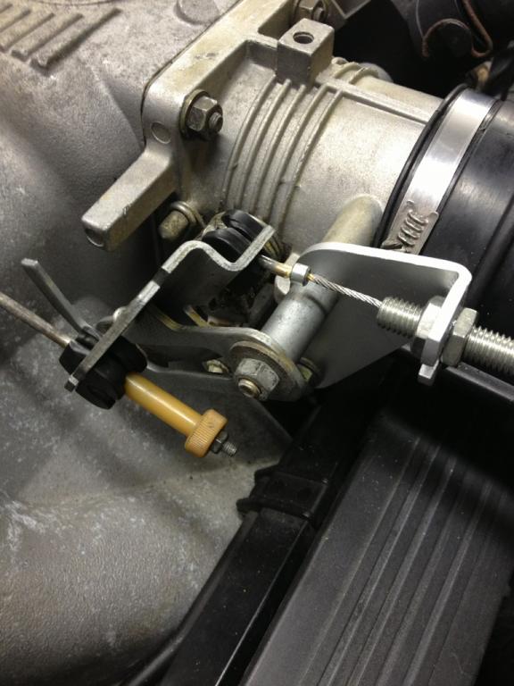

            #35
            Here's a pic of the kickdown cable bracket. Needed only to grind down the spacer on the upper stud and add a stud/nut at the existing attachment point on the throttle body. It's a bit rough. I'm sure someone else could do a better job.

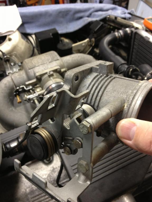

            Here's a pic of another throttle body I had. It had the extra spring and bracket to allow for 100% throttle and THEN kickdown. I didn't use it because the barrel was very pitted. The brackets might swap over, but there are embedded "hard points" and stops in the TB casting that I don't have in the TB I used. "Next time"

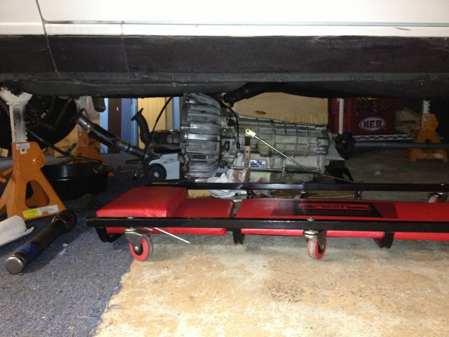

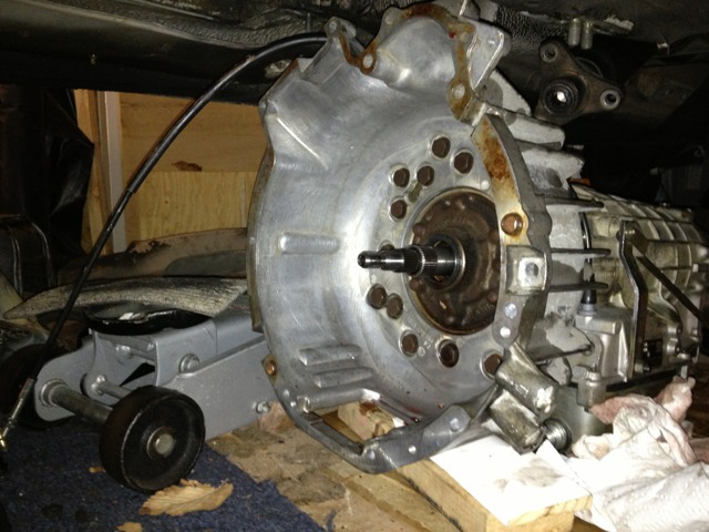

                              #44
                              Replacing the flex plate requires the engine and AT to be separated. During install, It appeared that there would be enough room to access the bell housing bolts for underneath. So I raised the motor with an engine support, pulled put the motor mounts, dropped it and the tranny down and there is plenty of room to get in there with some long wobble extensions. I left the TC on the flex plate, as it easier to separate that way, so that would also lead me to believe that a manual transmission with it's input shaft could be dropped the same way:
