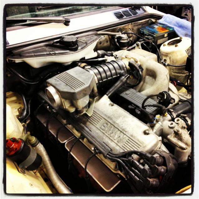

          89 335i m30 power, 4hp22 delivery
            OK moving along. Exhaust system is made up of e23 manifolds, e30m20 downpipes and a few odds-n-ends to get from the downpipes to the remainder of the front cat section.
            Here's where I cut the front section:
            HE>i
              Before getting the exhaust hooked up, I noticed that the rack-to-oil pan clearance was tight. Perhaps only a mm or two:
              I slipped some large nylon spacers between the mount arms and the stock m20 motor mounts. The spacers are really just large nylon washers about 3mm thick, and did the trick. I tried 6mm spacers, but I didn't have enough thread on the motor mount stud (I didn't feel like turning them over - that might have worked, but I like the raised " button" on the bottom).
              With the additional 3mm; I am guessing the rubber in the mounts will settle over time and the 6mm spacers may come in handy:
              HE>i

                      Here are the two m20 downpipes with added lengths. The two sections are "reversed" from the original placement on the m20, where I used the short stubby section with the flex to get clear of the firewall. I brazed an o2 sensor bung onto the straight section since I cut out the portion that had it originally. I am thinking there is a way to use it. "Next Time". The o2 will only be reading from the front 3 cylinders, but I don't think that's really going to be a big deal.
                      Oh I forgot to mention: I used the e23 manifolds since the e34 ones were too close to the mount arm. That was before I picked up a welder, so I'll be looking for a way to use the larger e34 manifolds and downpipes "Next Time"..

                        Just about ready to fire it up....I had to fab a bracket for the kickdown cable.
