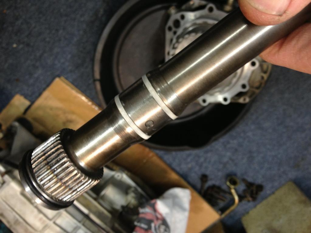

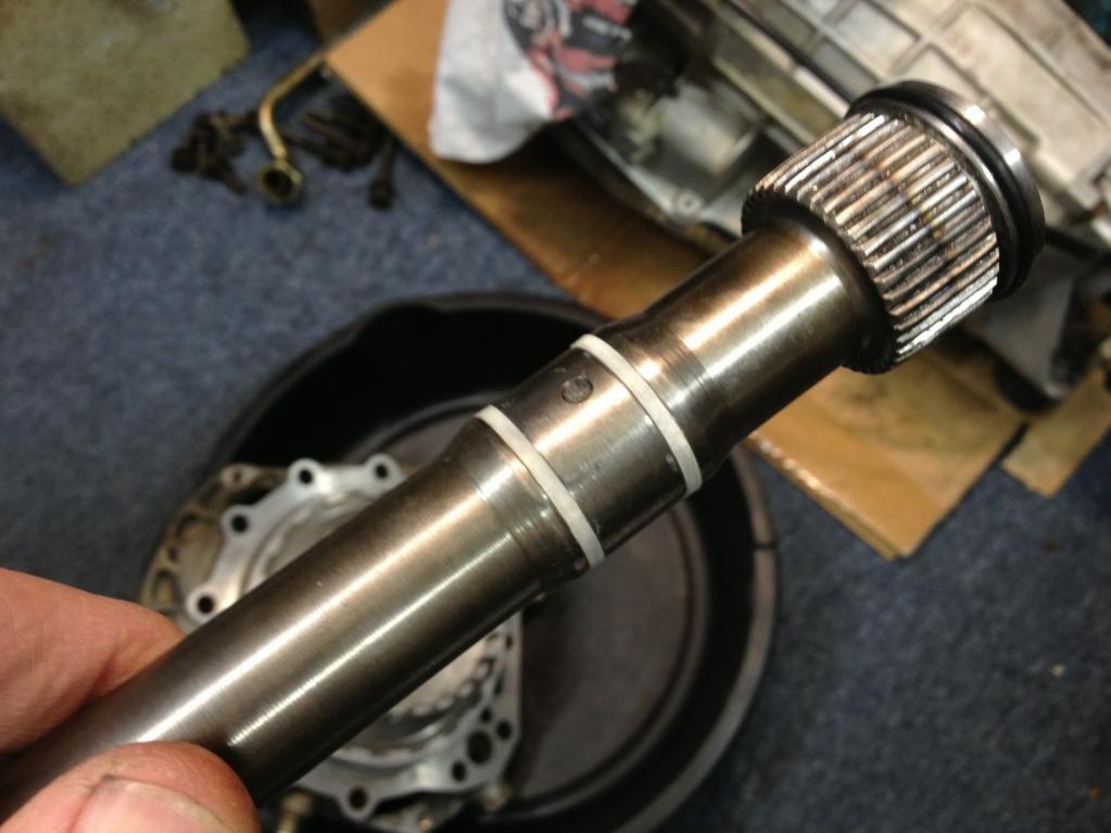

            G that's kinda how the AT comes apart. I think you can use a quality sealant at the AT front pump to case joint. If the gasket didn't get torn you can re-use it dry. Now is the time to replace the existing metal input shaft seals with the upgraded teflon. This is the new seals in place, then compressed with a hose clamp, protected by metal strapping, then the final compressed state before reinstalling. The shaft won't go back without damaging them unless you compress them:

              #51
              Ok, compressed AT input shaft seals:

                #52
                OK thanks, that calms my worries... I appreciate all the pics! Where did you get your hands on those seals? I have found whole kits, but do I need to get all those gaskets? Any luck on your work?

                    #54
                    Originally posted by G-Man the Visionary View Post
                    Did you get the shift kit k002 with the drill bit? Did you drill the hole?
                    yeah: http://transmissiontechnologies.com/...ent-seals.aspx
                    No, I didn't drill the hole. I've seen it in a few places on the 'net where folks mention not bothering with it, perhaps figuring that the rest of the AT is more likely to go kaput before these seals blow out. I *believe* that you only need to replace one of the metal seals (forwardmost, or TC, side) with the teflon, hence the kit above for (3) repairs, but the pics I've seen show both being replaced. Oh and you'll only need to compress the teflon seals for a short while. IIRC, I left the clamps on while I ate lunch; that's all.

                        #56
                        Not sure about why the input shaft isn't coming loose, but to put back together, get all the clutches and steels lined up as best you can, then put together. To get it all lined up, rotate the shaft as you are assembling. Don't push too hard or you could break one of the clutch discs; just keep turning. It'll go together eventually.
