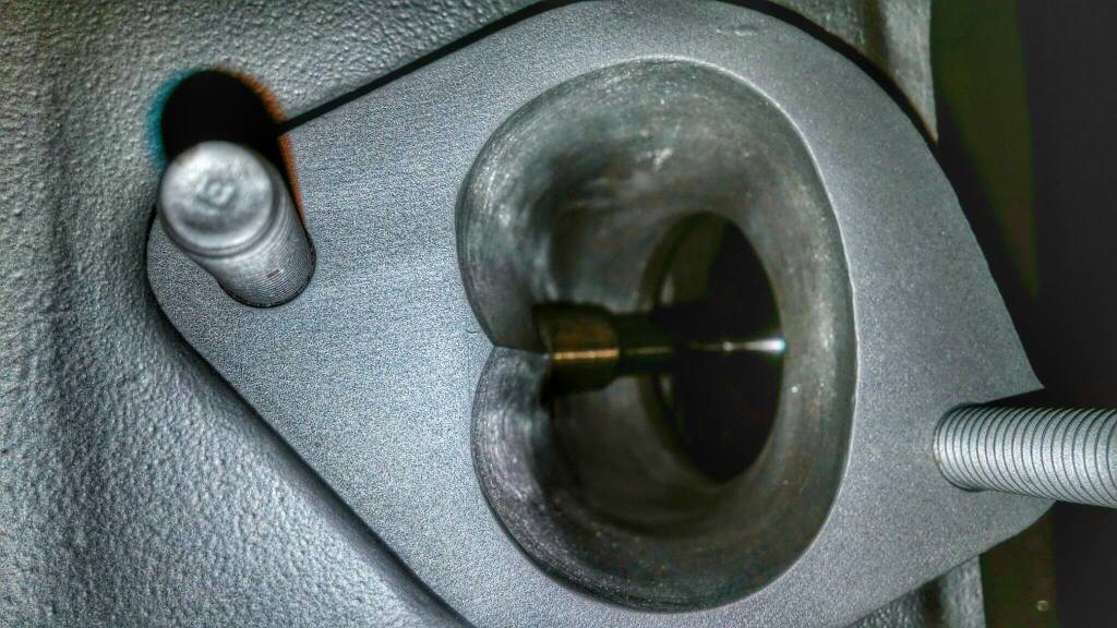

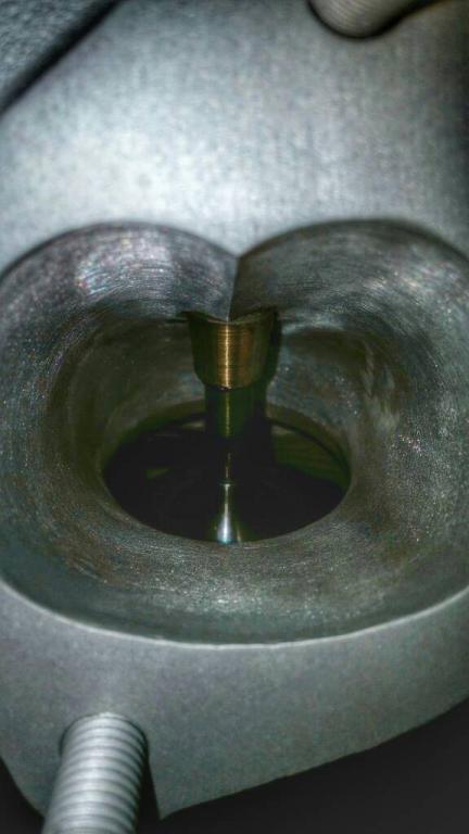

              Finally some updates..!! Finally finished porting the head and had it re-surfaced for MLS. Machined .017 to get flat and true. I have gathered all the parts to assemble the head, more updates to follow.
              Only ported top of the exhaust section raising it 1/4".

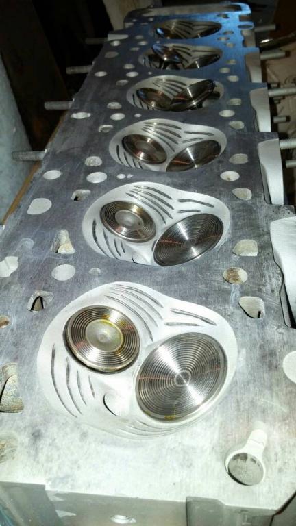

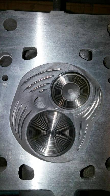

                    This is awesome. Looking forward to updates.... I have my m30 head done as well.Click image for larger version
ID:	7181956Click image for larger version
ID:	7181957Click image for larger version
ID:	7181958Click image for larger version
ID:	7181959Click image for larger version

                        What the heck is up with those cuts??

                          #72
                          Don't want to hijack this thread, so briefly. It's all about turbulence. Custom head by metric mechanic.
