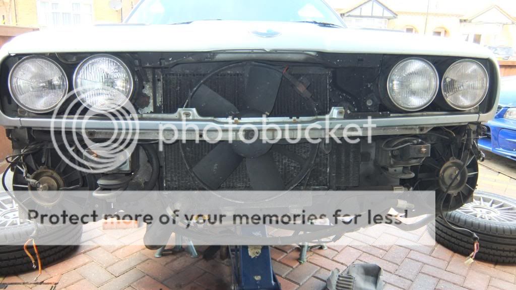

        Engine is currently off the mounts with a large socket over the stud of the rubber mount to allow for the couple of inches clearance I required to get the sump off (didnt have a crane so just jacked from the sump then supported it via the sockets on the rubber mounts), so in effect it is already broken free. Sump is only held on with two bolts currently as waiting for my E34 sump and pickup. For the pull out I could just whip the sump off again as it will be no big deal and the pickup is currently disconnected so will be a lot more clearance underneath.

                            Guys got it back in, position 3 as per the mounts supplied by e30.de. Everything seems to fit ok at the front crank pulley, rotor cap. At the rear the bulkhead seems fine at the head end but the lug on the side of the block is fouling on the transmission tunnel. One side already had been grinded off for exhaust downpipe clearance passenger side is my issue (right hand drive car). Do you guys normally grind these lugs off? Also seems like I have a bit of rotational tilt as the gearbox is not going down square on the mounts. causing me to have to wind it into position side by side on the mounts rathert than just jack the transmisson up and fir the mounts. So much so that it has delaminated one mount the rubber has streached and split.
                            Will get some photos up later of front clearance
