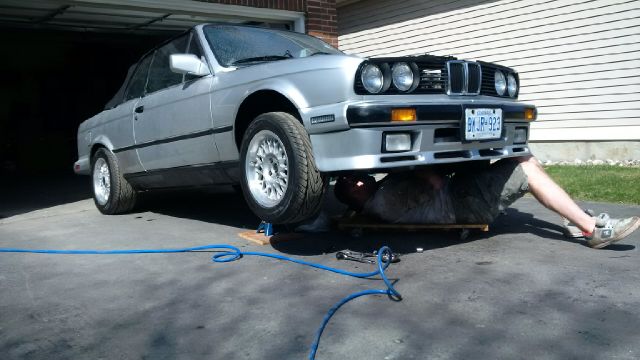

                    Today is driveshaft and tranny linkage install day.
                    More werk.
                    And my wifes killer mint 1972 Sears Glider 3speed bike
                    Originally posted by flyboyx
                    i have watched my dog lick himself off a few times
                    • SubDad
                      • Oct 2012
                      • 279
                      #85
                      I don't know about the bike itself, but that kickstand is a classic piece. Those and my Gramma's toaster, they made the same sound. And you have more perfect lawn in the picture than I have on my entire lot.
                      Now, ahem, E30-ville and your pictures: Just because I'm paranoid, I always sling a wheel or two under a car on jackstands so that if it falls off the stands it has something to land on other than my breathing apparatus. I generally use the spare to lighten the load, and I have somebody check on me periodically too.
                      May the shift linkage treat you kindly,
                      Signed, Concerned of Nepean
