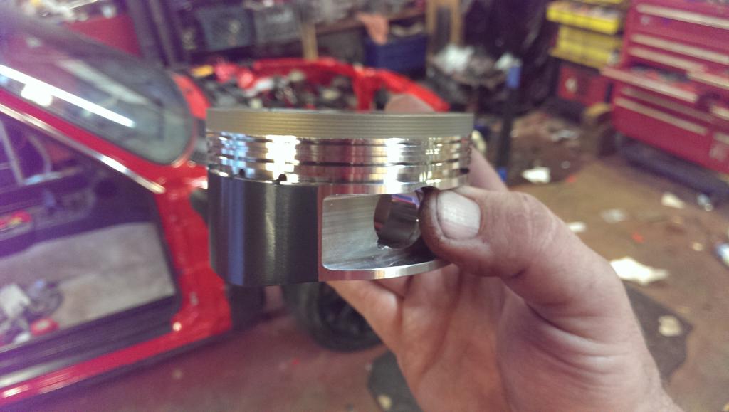

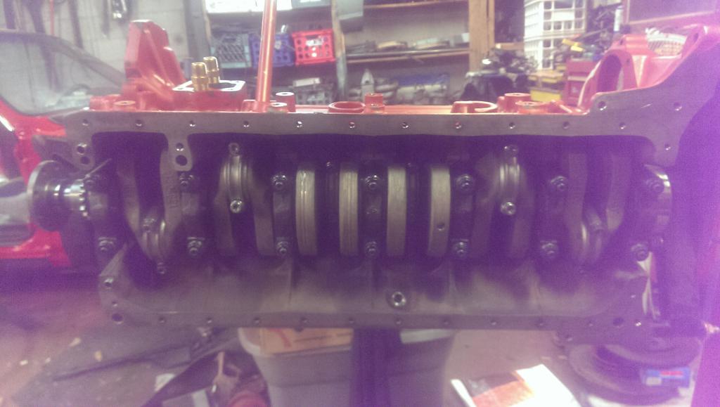

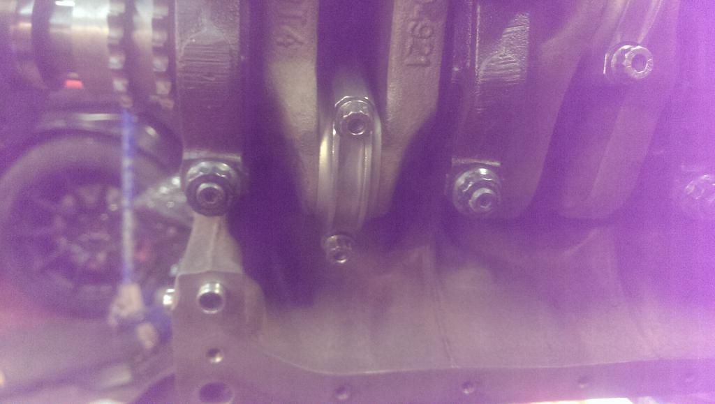

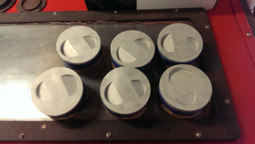

With the crankshaft installed, I had finally come a point I have been dreading...sandblasting the tops of my brand-new forged pistons
No going back now.

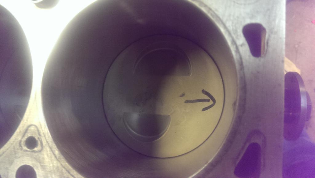

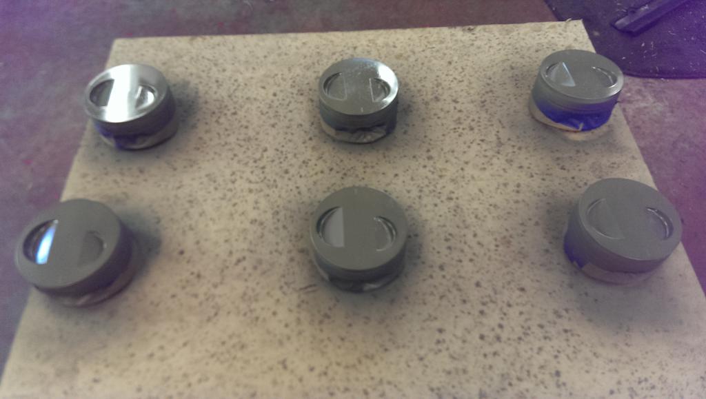

After cleaning and masking, it was time for the Piston Coat. Cook for 20 minutes at 175 degrees, then 300 degrees at 60 minutes, allow to cool and...
Gearhead muffins!
A little more cleaning and taping, and a light coat of Microfilm Lubricant painted on for good measure.
Looks almost like the product of skilled labor ;)

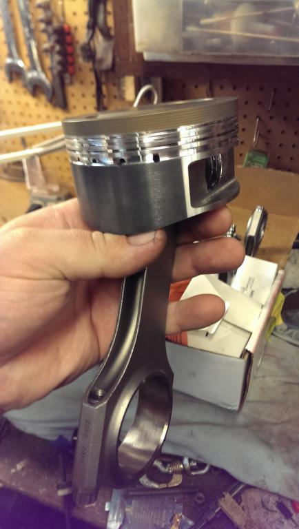

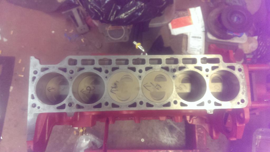

Time to break out the rods! I used wooden blocks to gently press the pins in with my vise, then (eventually) managed to install the retaining clips--occasionally after some swearing and a frantic search for a pin that had broken free and achieved orbital velocity...
