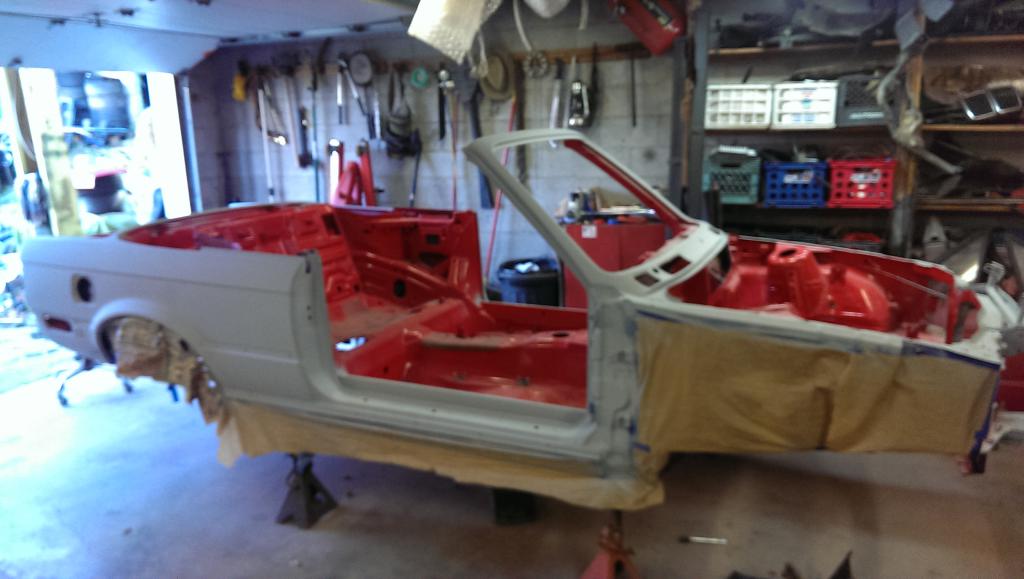

            Bodywork Update
            The body was safely returned to its jackstands--it was far more exciting than it probably should have been, involving a cherry picker, brake rotors used as balancing weights, and a very brave fiancé. Once on the ground, it got the bondo work finshed up, and several more coats of primer.
            Sand, clean, paint, repeat for effect...and finally time for the fun part!
            The boat paint went on great! Real easy to spray, no issues with runs or sags--even when my gun was messing up ;)
            It gets the bonehead bodyman seal of approval!

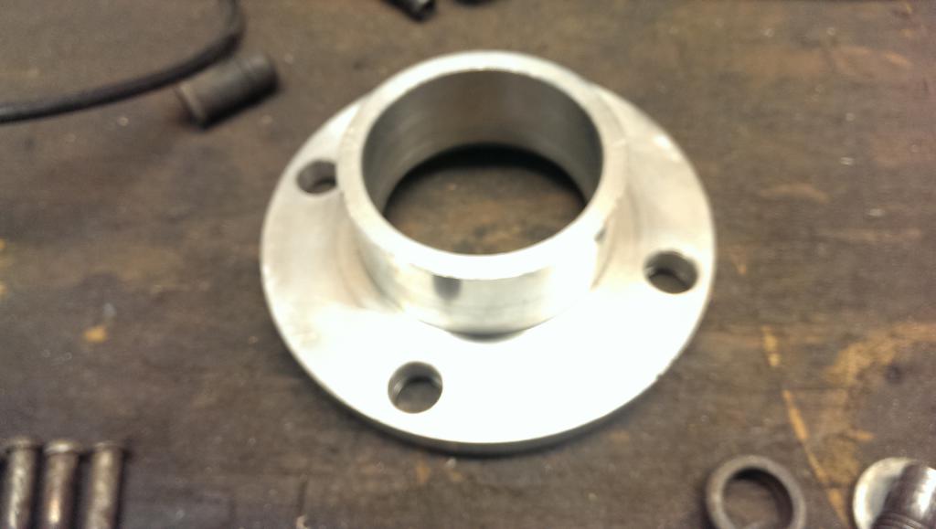

            Braking Update (Part 1)
            Remember those two round chunks of aluminum?
            After some time on the lathe, they have become much more part-like :D They are almost done, just have to get the bottom of the inside radiused a bit better, so it lays flat.

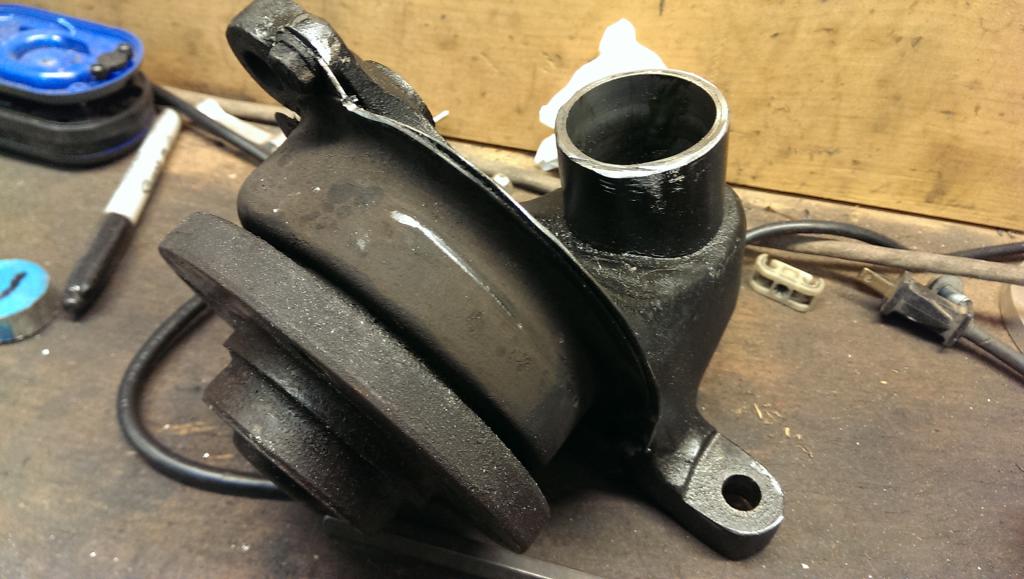

              Braking Update (Part 2)
              The parking brake has been a sticking point for some time, but I finally figured out a solution:
              It fits the Hyundai Tucson, Sonata, Elantra, and Kia Sportage--and more importantly, is the right size for the inside of the Impulse rotors! It did require some modification though...
              However, it came together beautifully after that

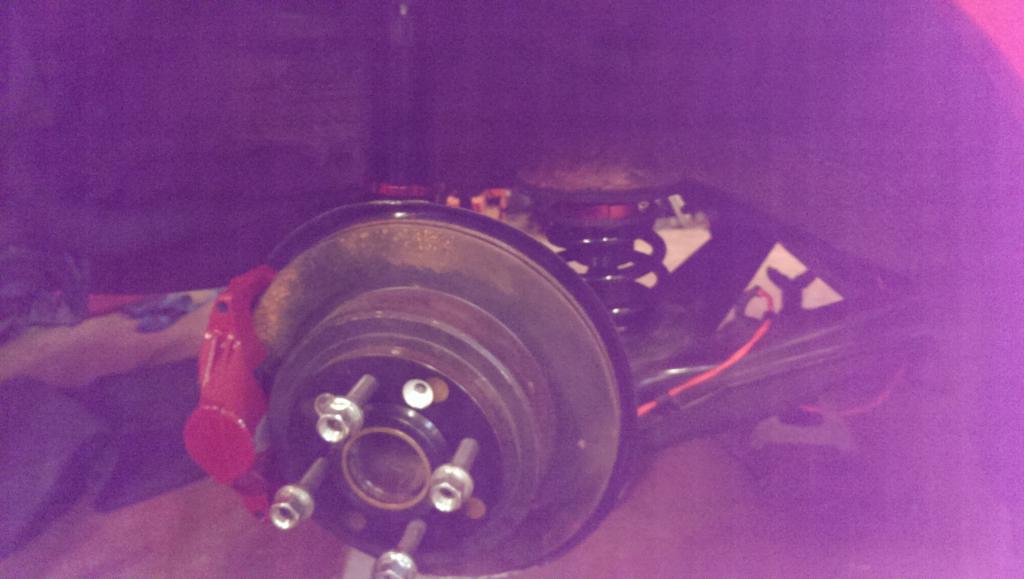

              The rear brackets are pretty much done as well...

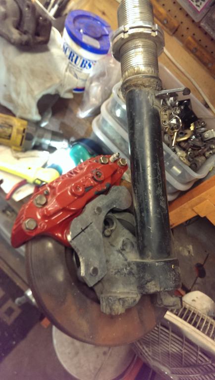

                  Braking Update
                  I measured as best I could, and took the plunge--the pilot holes for the front caliper are now drilled, and I bought some 6061 round stock to TIG on as spacers.
                  As for the rear setup, it appears to be finished...now comes the plumbing and wiring ;)

                  I finally got up the nerve to cut off the strut tubes, and I have set everything up for welding the lower coilover tubes on:
                  As for the rear, it's pretty much a bolt-in affair...so here's a shot of the rear assembly, detailing the poly bushings and swingarm adjusters:

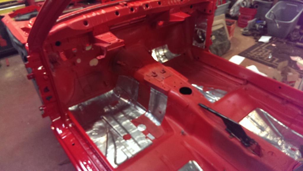

                        Interior Update
                        With the paintwork on the body finally finished, I could finally get some actual work done! I started with sound deadening panels:

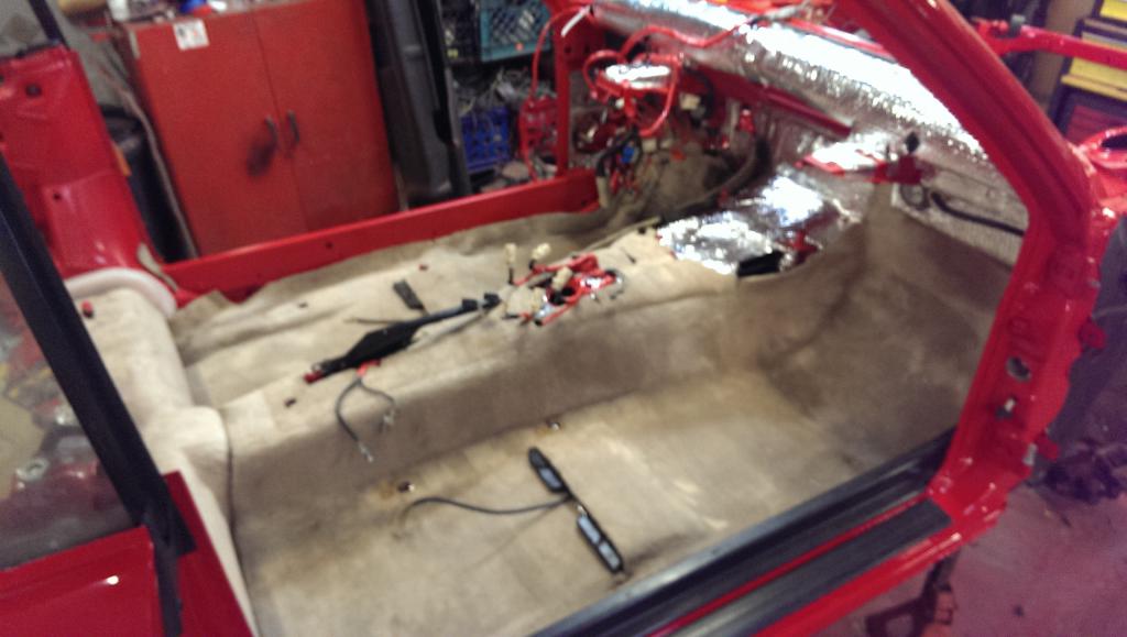

                        Thank you Home Depot! FWIW, I did quite a bit of reading before deciding on the "Peel 'n Seal method". While it's true it adds some weight, and is nowhere near as effective as modern Dynamat, it's very similar to what our cars originally came with, and works well enough for my purposes :)
                        Next, the insulation--also courtesy of Home Depot (or Racer's Depot if you're trying to be cute):
                        That's a layer of duct insulation held down with aluminum tape--it's good for an R-6 rating as installed. It has aluminum foil on both side, and essentially heavy duty bubble wrap in between. The concept involved is similar to how Lizard Skins works.
                        After that came the electrical harnesses, a task so foul--so hellish, I did not save for posterity. A word to the wise: next time you see your harness and think "that cloth tape is in terrible shape...I should really rewrap my harness" walk up to your cat and rub his tummy for about 10 solid minutes. At least that will hurt less
                        Anyways, with that done it was time for carpeting. I took a tarp, made a redneck swimming pool, dunked the carpet in there, and sprinkled in OxyClean. I let it sit overnight, then got out there with a stiff nylon tire brush and scrubbed the crap out of it. When I pulled it out, the water was brown and chunky!
                        It had been growing algae, had grease and rust stains, and had brake parts laying in it for a year, but after all that, this was the result:

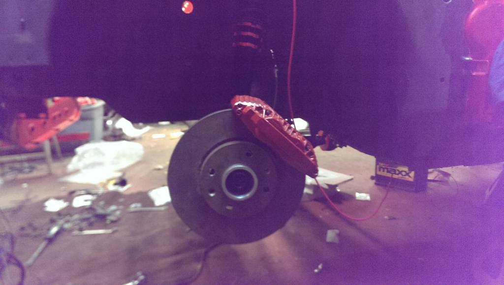

                          Braking Update
                          The front caliper adapters came out perfectly!
                          I've redrilled the new lug holes in my Sonata rotors, so the next time you see all this, it should be attached to the car :)

                              Suspension Update
                              Thanks to those shiny new adapters, and my new lower control arms, it was time to bolt down the suspension and set the coilovers. I took out the springs, and adjusted the compressed damper height.
                              At full compression, it is about a 1/2" from hitting the studs on the top of the wheelhouse.
                              I marked the length of the damper from the top of the damper to the bottom part (the part that's welded to the knuckle), and transferred it to the other side. After that, I adjusted the dampers in the rear to match the (uncompressed) height of the fronts.
                              It's not exactly a lowrider, but it appears to be the most effective use of the damper travel. I figure it can adjust the ride height when I set the preload on the springs.

                              Not only that, but I'm going to have to add clearance to the front of the front wheelwells, to permit full steering travel :???:
                              Braking Update
                              I wanted to get the rest of the hydroboost system in place, and that meant fabbing up a bracket. The system looked like this when I pulled it out:
                              So, I kept the dimensions roughly the same, and tucked it close against the strut tower.
                              Spiffy :D I used a mixture of E30 and E23 hoses, but I did have to extend a few of them...the hydraulic hose shop is not cheap, but they do very nice work. More on that later ;)

                                Bodywork Update
                                With the suspension nearly done, I realized it was finally time to start getting everything else looking nice--not to mention getting a better idea how to fit everything inside the panels. Once again, the stripper comes out...
                                If you think watching paint dry is boring, watching paint undry is somewhat more fascinating :) Still, since I had some time to kill, I figured I'd be productive...
                                Weatherstripping, locks, and plastic panels? Check!
