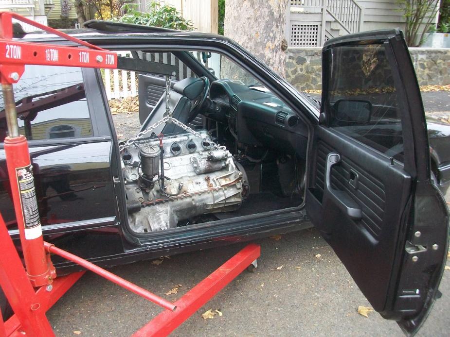

      Throwback to 2010. Wish I had had a truck when I picked up mine. Good luck with the swap.
