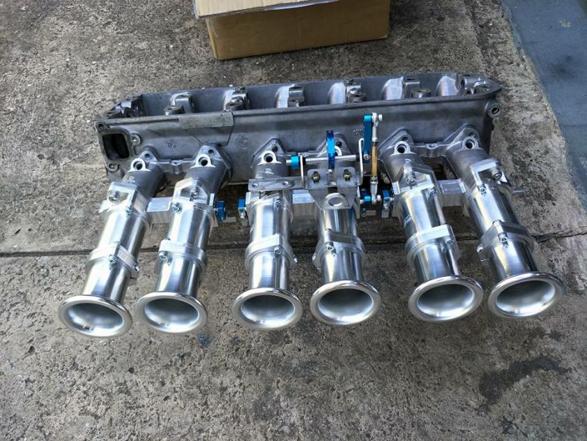

                    Cleaned up the ITB's to cure boredom appreciate unicorn slippers in the corner,
                    PPM Valves ordered +1mm intake & exhaust - once delivered head is getting love

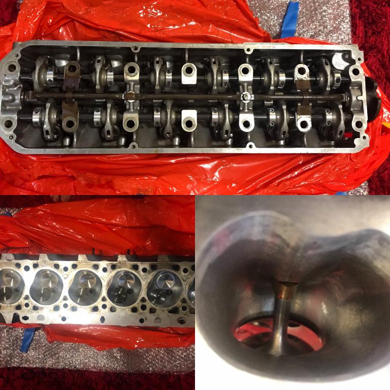

                            So I’ve made some progress on the build;
                            Head flows on the intake 210cfm at 9.4mm lift approx 22% higher than standard, HD springs, +1mm exhaust valves & stainless intakes(standard sized because I ordered the oversized early model m30 which you guessed it is the same as the late models standard intake valve size....) 294/294 cat cam, shot peened & crack tested oem rockers, new hardware throughout, & ie rockerlocks which to be honest their finish was rubbish
                            Picked up a late model m90 block(loses the raised cooling channel), will be running my b35 crank to benefit the 86mm stroke.
                            So the bottom end will be;
                            144mm max speeding rods
                            B35 crank knife edged & balanced
                            m90 block, dipped to clean out the cooling channels, line honed
                            Rotating assembly balanced
                            11:1cr wiseco pistons(the last piece of the puzzle)
                            S38 head gasket

                              I also am moving away from the s38 itb setup & will be using Rama’s itb kit he fabricated this off my head(joys of having him local). The port angle & runner design works out much cleaner. They still require modifications to the thermostat housing & we are looking at a few options to with move the thermostat housing slightly forward or the alternative of just rotating the interfering outlet
