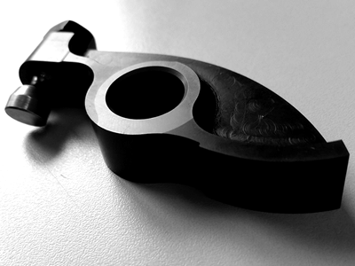

            the PPF cam is
            another cam that looks ok is
            some plots by others
            on the m20 the HD rocker arms give more lift that the standard ones, i dont know if it the same with the m30 version
            catcams also offer uber $$$ billet rockers now, so they should be able to generate some better profiles as i think the pads are longer

              The catcam rockers do look really nice, the ppf/km ones have a longer pad similarly to the catcam ones just less finely finished.

                the km rocker for the m20 have a different pad profile so when i tested them i lost lift on the m20 cam, not sure if the m30 are the same
                the catcams are steel so they will be nice and stiff, probably a bit heaver but the weight difference isn't that important as its only rocking.
