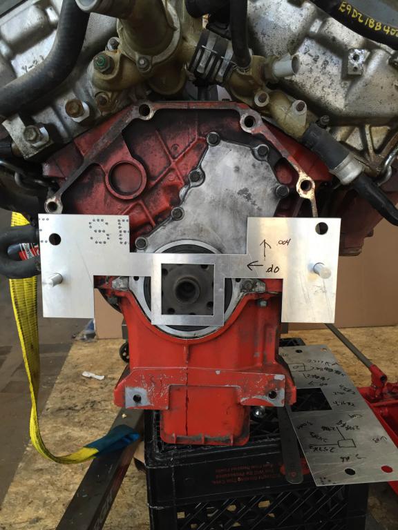

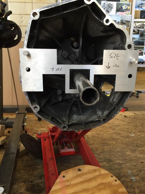

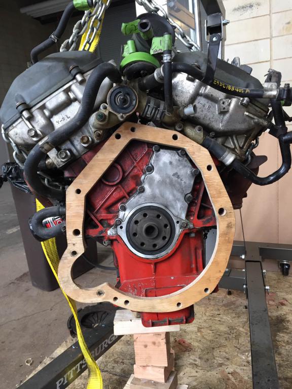

        The project is moving slowly, but I believe I am close to having a final adapter plate design. I added a picture of the wooden adapter plate. I ordered an aluminum plate, and hope to make the final part soon. I re-drilled the SHO flywheel for the s2000 pressure plate, but did not realize that the s2000 flywheel is a stepped flywheel- so now I need to machine that step into the SHO flywheel, shouldn't be too hard but the machine shop at my school is backed up right now. It looks like I will be able to get a very thin pilot bushing in my crank, so I'll make that soon too.
        The thermostat is on the back of the engine as it will be mounted in my e30, and the thermostat itself closes off a bypass when it opens- something that could be tricky to replicate with a "remote" thermostat. I think I may ignore that problem for now and try to get the engine in the car, then come back to it.

                            Quick update here: tomorrow morning I'm waterjetting the basic shape of the adapter plate out of 1/2" aluminum, and then it will be on to the mill to get dimensionally accurate holes. I waterjetted a plate of thin aluminum that slipped over the dowel pegs and had a hole in the middle, which allowed me to measure to the crankshaft of the engine and input shaft of the transmission to make sure the two bolt patterns are perfectly centered on each other- which they weren't. I'll just shift the two patterns relative to each other in autocad. The pipe is a slip fit over the input shaft of the transmission and just extended it out so that I could get a reading.
