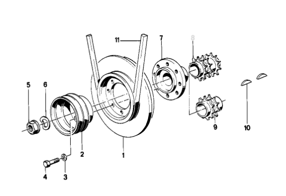

                              One other thought on clearance....remove the entire AC/PS pulley (see #2 in copy of picture from REALOEM) from the crank, leaving just the WP/Alternator pulley. Weld a pulley to the alternator pulley (see picture....there was a company making something called an Add-a-pulley for offroad welders) to drive the PS...seems do-able. The company does not make them anymore but he describes a way of doing it yourself. Link:
                              ZENA Add-A-Pulley power takeoff kit information page -- photos and diagrams showing methods of use

                                Z3M radiator clearance...now it fits!
                                Problem solved by removing AC pulley (car never had functioning AC anyway) from combination AC/PS pulley.
                                Added almost exactly 3/4 of an inch clearance between pulley and radiator. Radiator sits on stock mounts and hold-down. No further mods required, nearly an inch of clearance, overall.
                                Held crank with 36mm socket and long extension, removed 8x 13mm bolts, removed pulley. Used my flush cut saw with metal cutting blade (WD40 to cool). Took 5 minutes and was very clean. Polished rough edge with emery cloth and gave it a shot of black paint. Done.
                                Looks factory and gave me the clearance I needed to use the larger radiator.
