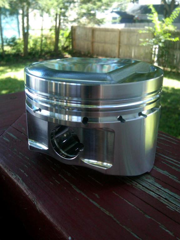

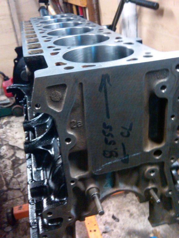

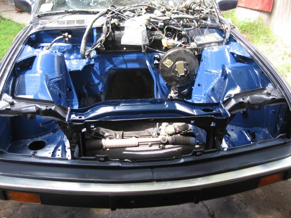

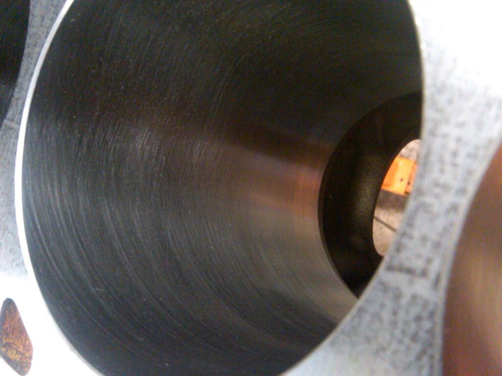

                            Well since I'm nearly done I guess I can post something:
                            89 Royal Blau vert with custom engine harness
                            B35 with 10.50 C.R. lightened and balanced stock rods (removed the pads on the big end)
                            worked head/N21 grind cam (simply beautiful courtesy of Paul Burke)
                            92.5 mm forged pistons which weigh 435 grams compared to stock 522 g.(also from Paul Burke)
                            standard size Glyco main and rod bearings
                            E28 535i radiatori
                            Getrag 260/6 from e34 with 533i flywheel balanced to E28 clutch & pp, UUC dssr
                            87 Eta big guibo driveshaft fits with no modification
                            home ported port matched intake, Bavauto long tube headers into y pipe with 2 1/2" single outlet to resonator to single inlet/outlet Walker muffler
                            3.5 Bar FPR gives about 50.8 psi so the injectors flow a bit over their 24 lb. rating.
                            67 mm bored throttle body
                            wide band o2 sensor
                            LS "D585 " truck coils on valve cover for sequential
                            Bosch 24 lb "715" injectors
                            home brew cold air box/filter setup with flow stack and SB cone filter
                            Revshift m20 motor mounts
                            E21 "green" transmission mounts
                            Rogue Engineering oil cannister cap with oil temp and pressure senders
                            MS3X in progress...
                            Otis' mounts in position 2 (gives me 1" between fan coupling on water pump and the radiator)
                            80 degree t stat
                            VR-1 20W50 oil
                            NGK BPR6ES plugs at .032"
                            I'm excited because next week I'm finally going for some dyno tuning. I had to track down a couple issues: fully bleeding the cooling system and not having one of the injector terminals fully seated. Oil temp and pressure looks good and my Spal fan kicks on and off as it should. Im going to a shop near Boston that has a Dyno Dynamics machine. They are supposedly known for low numbers /they calculate a 25% drivetrain loss so I'm interested in what numbers I get. Before that I am waiting on a new TPS to arrive because the current one has no continuity between pins 3 and 18 at full throttle and so the computer isn't getting the signal which means the tune that's in my chip isn't working to potential and is likely lean. Idle is currently Ok at about 900 rpm but I expect that too will improve because it seems a bit rich. I think the base 10 to 1 tune I got from Miller is for 19 lb. injectors. Most likely going to run near 50 lbs. of fuel pressure. I would like to run 91 octane but most of the stations don't have that grade; they have 89 and then jump to 93 so I will probably tune for 93. I'm going to keep a conservative redline of about 6500 rpm.
